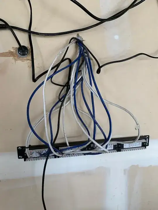

And here is the patch panel (Yikes, I know. Secondary question will be how to figure out which cable in this rat's nest goes where)
Patch Panel

  • Can you post some pictures of a wall jack, the power injector setup, and the patch panel? Not sure how an antenna would have tied into ethernet cables. – PhilippNagel Mar 26 '20 at 21:11
  • See new pictures added; I can provide a picture of a wall jack later if still necessary. – gregmacfarlane Mar 26 '20 at 21:23
    Better/larger pictures would be helpful. There's a size limit to them, but these are not even close and it's not possible to zoom in to see any details such as actuallly reading the upside down text on the power injector... – Ecnerwal Mar 27 '20 at 01:16
    "*plugging an ethernet cable into the router and the nearest wall outlet won't suddenly bring wired ethernet into all of the rooms of my house.*" Actually, have you tried this? My parents had this done in '04/'05 for their ranch-style house (office at one end of the house with modem and router)... there's one "out" jack for a cable that goes from the modem to the wall. Other ethernet ports in the house (bedrooms at the other end) were all connected to a switch somewhere (I'm guessing) so we could just plug a hardline into them and it would work. – TylerH Mar 27 '20 at 21:01

  • See larger resolution image now attached. – gregmacfarlane Mar 27 '20 at 22:40
    ...so how do you plan to plug anything into that patch panel? you have the backside facing out (where wires are "punched down" once to connect to the panel) and the jacks/ports (where patch cords plug in) facing the wall with no space to plug in cables, as far as I can see. If you want to screw it to the wall, add some wood blocks to space it out far enough, and flip it around so that you can access the ports/jacks (assuming you don't want to buy a tiny wall-mount rack, which frankly, I wouldn't for my house, though I'll pick one out of stuff headed to the dumpster if I spot it going there.) – Ecnerwal Mar 27 '20 at 22:50
    Finally getting back to this. It is in fact a patch panel, with ports on the reverse side. Ports 1 through 14 are wired, but none of them appear to be live. – gregmacfarlane Apr 18 '20 at 22:58
    I would not expect any of them to be live until you plug something into them ala the **What goes where?** section of this answer. Please try that. – Ecnerwal Apr 19 '20 at 00:33

Anyone notice those silver screws bolting the supposed patch panel face first to the wall?
I don't think that patch panel is what you think it is.
It looks like something that splices together pairs of ethernet cables. Not something that provides rj-45 outlets (a patch panel). These are more common in telephony where the telephone company comes in on the bottom, and your outlets go out on the top. It's not really used much at all for ethernet networking.
BUT you can salvage the situation.
First, make sure it's not actually a patch panel: actual patch panel bolted uselessly face first to the wall by taking it off the wall and checking for rj45 ports.
Then you can either buy an actual patch panel and a pushdown tool, and transfer the wires to it. (Remember to trim each wire 1 inch first, untwist, and push down a fresh spot on each conductor. Do not take the easy way out and try to reuse where it's already been bitten. The push-downs depend on the malleability of copper to make a good connection by deforming it during the push)
Or you can crimp them all with rj45 heads. so called home-runs. This is less professional but works just fine in a house. I've 'done the I.T.' for 20 years and used home runs in my home built newly for me a couple years ago. The cables are long enough I could turn it into a patch panel later, but I haven't felt the need.
If you want to go patch panel route you will need to buy the patch panel ($30-ish) and a punch down tool. The cheap kind ($2-3-ish) will do. cheap punchdown tool
