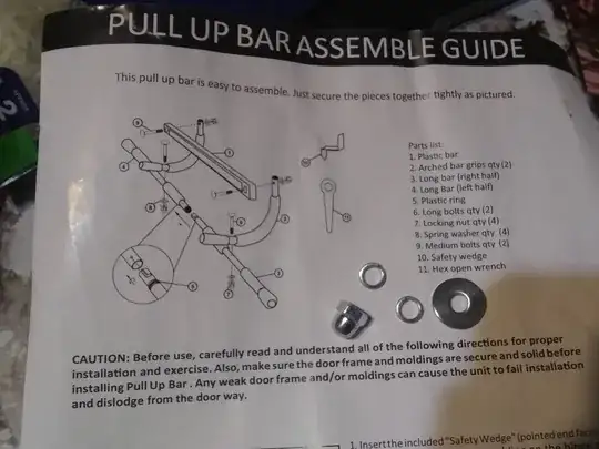

So I'm assembling a pull up bar and its assmebly instructions look like this
In the parts list it mentions only one type of spring washer (quantity 4).
But it actually came with two types of washers (quantity 4 each), type1 and type2.
Am I supposed to use both of them? And in what way? Any help would be appreciated!

They gave you four lock washers instead of 4 locking nuts. No problem. Install the bolts as shown in the instructions. Then install a flat washer on each bolt followed by a lock washer and then the nut. Tighten as specified.

    On a tangent, a lock washer basically does nothing close to a lock nut. Do regular checks with this pull up bar, because your lock washers will loosen MUCH faster than a real lock nut. Replace with a real lock nut if you can; you don't want to break your neck over $10 worth of nuts. [Info about lock washers](https://engineerdog.com/2015/01/11/10-tricks-engineers-need-to-know-about-fasteners/) – Nelson Apr 02 '20 at 06:41

  • @Nelson If I don't have a real lock nut, would you advise using just the flat washer? – Da Mike Apr 02 '20 at 19:41
    @DaMike The lock washers will be fine, I've used them in heavy machinery for 55 years and never had a problem. You will find them in probably every car built. Maybe NASA doesn't like them but you're not mounting your bar in the space shuttle. Looking at the position or your bolts if the nuts should ever loosen up you'll feel it long before they fall off. you should be doing regular checks on a bar like this anyway. – JACK Apr 02 '20 at 22:57
  • @JACK I'm not against lock washers in general. I'm against REPLACING a lock nut with a lock washer. Their performance is not the same. I don't think you went around, took out existing lock nuts, and replaced them with a lock washer for 55 years and encountered no problems. – Nelson Apr 04 '20 at 18:10
  • @DaMike Adding a second nut like UuDdLrLrSs mentioned would work too. For nuts to fail catastrophically is a little rare, so it won't suddenly break on you, but it will get loose, and you need to stop using it when it is loose. The pull up bars also don't need to fail catastrophically to hurt you. If it shifts suddenly when you're hanging on it, it can loosen it off the door frame, or slam you to the frame of the door, or you slip off and smash your head into something. Read the instructions for safety checks. – Nelson Apr 04 '20 at 18:16
  • @Nelson LOL No I did not.... but I would hope the lawyers got with the manufacturers and made them retest the differences between the two locking devices... stay safe out there. – JACK Apr 04 '20 at 19:24
Put the flat washer on first then the split lock washer and finally the nut.

They are normally installed so the split-ring "lock" washer is against the nut, and the flat washer is between the split-ring washer and the surface. This is to prevent damage to the surface. It appears they did not provide any flat washers, is that correct?
It appears they provided locking nuts, the kind with a piece of nylon or fibrous material in it. So you should be good.
However, I'd like to add some content about split-ring "lock" washers.
Both the Germans in the (I think) 1930s and NASA in the (I think) 1960s determined that split-ring spring washers, aka split-ring "lock" washers, actually speed the loosening of a nut under vibration when no other method is used of locking the thread in place.
This link contains quotes and a chart from the NASA paper. The chart on the last page is quite illuminating. http://hillcountryengineering.com/wp-content/uploads/2011/10/Split-Lockwashers-Separating-Myth-from-Truth.pdf
If you want a deeper read, here is the 100 page NASA Fastener Design Manual. https://ntrs.nasa.gov/citations/19900009424
Polymorph
I got the same exact diagram for my pull-up bar, listing parts #1-11 and split washers were included additionally. Accidentally, I assembled the pull-up bar without the split washers, only noticing the split washers after finishing the assembly with the flat washers. Nevertheless, I have been successfully using the pull-up bar at home for 3+ months with no issues. May tighten the bolts after a year use anyway.Assembly Guide
