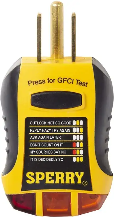

the black wire from the panel side comes out as white (neutral) on the kitchen end, which means the white is hot and black is neutral. The red wire matches fine. I arrived to that conclusion by using a plug tester with three lights as well as a multi meter.
Not frickin likely.
This is a false reading due to the oddities of MWBCs, intersecting with notoriously bad testers (magic 8-ball testers are particularly notorious in giving you laughably wrong indications), intersecting with a lack of the depth of experience you need to troubleshoot MWBCs.
The wires are not transposed at all. That did not happen.
You did not do an illegal connection.
You did not leave yourself 18" of slack somewhere so that you were able to insert a legal connection that you plumb forgot about.
Treat the 3 above points as absolute fact (because they are) and cross off any conclusion that does not agree with those facts. Peel the label off the magic 8-ball tester and throw it in the trash, and cross off any theories that flowed from anything that label said.
Things actually worth looking for are bad connections at terminations, breakers which indicate on but are off, breakers mis-phased (there MUST be 240V between red and black; this is mandatory!), faulty bus stabs, shorted (nail through them) wires, and broken wires.
Voltage must be:
  • Black-N: 120V
  • Red-N: 120V
  • Black-Red: 240V (or 208V if NYC)
  • N-G: less than 3 volts
This is a more accurate label.
  • Is this a picture of what you're referring to as notoriously bad 8th ball testers? – amphibient Apr 10 '20 at 20:12
  • So are you saying that it is entirely possible that this is a single piece of unjunctioned cable from the panel to the kitchen and that I'm getting such test results because I connected the beginning to two breakers as opposed to a tied pole double breaker? In other words that there is no mistery JB along the way where the suspected transposing takes place? – amphibient Apr 10 '20 at 20:14
    I am saying that pictured tester has more useful indications than the one you have used! :) As for "So are you saying", read my answer again. There's a lot going on. But yes, I am extremely confident there is no mystery JB where someone might have done something inexplicably stupid and then forgotten about it. I can't guess what the real cause might be, but mind you, all you've talked about is conclusions; you haven't given us hardly any raw data. So I have no data to guess on. – Harper - Reinstate Monica Apr 10 '20 at 20:38
