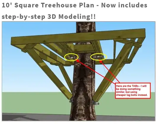

I'm planning on building a modest treehouse, on a tree whose trunk is oblong and whose long sides are probably not exactly parallel to each other. Because of this, I had the idea where instead of using lag bolts to screw in the joists on those oblong sides, I want to screw the lag bolts independently into the tree, and have the joists sit on top of them. This way I could have a perfectly square floor even if the sides of the tree are not parallel - it gives me some flexibility. It's a similar idea to a TAB (Treehouse Attachment Bolt), but a much cheaper version, as TABS can cost from $200 - $400 each! I want to make sure the bolts can hold enough weight when screwed in partially. Here's a screenshot of a similar plan where they're using TABs (highlighted in the screenshot - I will be using lag bolts instead of TABs - and I'll probably have 2 on each side):

  • Hmmm...so you’re going to drill the 8” long bolt 4” into the tree. If the tree has about 1” of bark, then the bolt will only be embedded about 3” into the tree. If the “load”, from the framing, is placed on the remaining 4” of the bolt, it seems like there will be tremendous rotation of the bolt through the tree. That rotation is “with” the grain and could cause the grain to “open” over time. – Lee Sam May 06 '20 at 18:32

I would counter that this is very much not what lag bolts are for. As comments suggested, drill through a full board tangent to the tree.
There might be a reason :-) that TreeHouse bolts are that expensive - they're designed to carry significant weight.
Otherwise, I would consider using triangles of 4x4 and run two long lagbolts (each) thru them into the tree.
