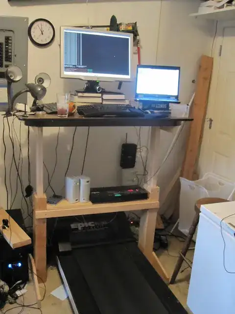

I've built this desk twice. It costs me ~$100 USD in materials:
And here is my version of the desk:
You can adjust it, but it is a little difficult. However, you can fit a modified treadmill under it as you can see in this video of me using the desk. I'm able to type comfortably while walking at 2.2 MPH.
If I may presume that the reason you want a height-adjustable desk is so you can sometimes sit and sometimes stand ( or walk!), then take the idea of height-adjustable and flip it on its head. Just buy a tall chair instead. (I only have a stool at the moment):
