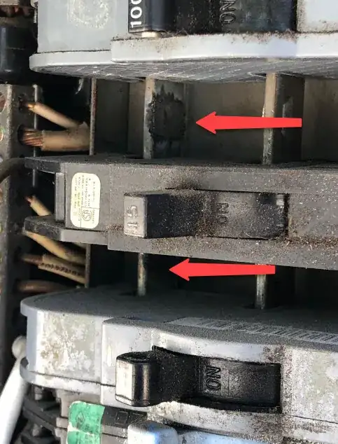

I have an old electrical panel. Some of the circuits were flickering. When I checked the breaker to the associated circuit I found that the bus bar had "porous" looking buildup of metal at the location. See photo showing two arced bus bar sections. I can also still hear some occasional tiny sizzling/arcing noises coming from the breakers but don't know which ones are making the noise.
Can the metal buildup be filed down to the bare metal making the slot reusable?
I saw a bus bar replacement at home depot for $60. Is it worth time and money to replace this or should I be looking for someone to replace/upgrade the entire panel?

    If you saw this bus online could you post a link? FWIW I won't work on circuits and breakers in any Zinsco panel. 20 years ago my parents bought a house with a Zinsco panel, I immediately gifted them a new panel. – NoSparksPlease May 26 '20 at 21:50
  • Not a duplicate, but important reading: https://diy.stackexchange.com/questions/152452/20a-home-circuit-breaker-stuck-in-tripped-state/152469#152469 I'm sure some of the experts will be along to elaborate more. But basically, this is one of those situations where *even if you know what you are doing* you are better off replacing than repairing. – manassehkatz-Moving 2 Codidact May 26 '20 at 21:52
    Zinsco panels were notorious for causing fires because of bad connections to the bus bars. Replace the panel completely. – JRaef May 26 '20 at 22:04
    You really need to think about replacing that panel as soon as you can. The arcing and sizzling sounds are scarier than gunshots and for a good reason. Those panela are fire starters. – JACK May 26 '20 at 22:49

    Here's a thought: filing the bus bar down to get a smooth surface will make the bus bar _thinner_ which means that the breaker's press-fit clamp will have an _even worse_ connection than it does now (it relies on pressure to make a good, tight fit). Because the fit will be _looser_, instead of _tighter_, you'll end up with even _more_ arcing. At **_best_**, you'd need AFCI breakers to protect your house and yourself against that. They probably don't make AFCI breakers for Zinsco panels. At worst, even with AFCIs, you'll start a fire and be replacing the whole house. – FreeMan May 27 '20 at 11:58
    You really need to replace the panel. Sorry, but Zinsco are bad bad panels. Where I live you can't even get insurance on a house with a Zinsco panel. Sometimes the breakers "weld" themselves to the buss bar, sometimes they don't trip when they are supposed to. Replacement breakers are notoriously expensive. – George Anderson May 27 '20 at 15:56
No, cleaning the bus is not acceptable. Never seen a replacement bus for Zinsco panels. The existing breakers reportedly have 1300 series aluminum alloy that is not suited for non-bolted connections like the connections in the old breakers. A replacement bus to be safe would need to also have replacement breakers, that start at $30 for a single pole 20A breaker, and a 2p30 is $65. The math starts to get rough, and then would be worried you might not end up with a quality install anyway.
