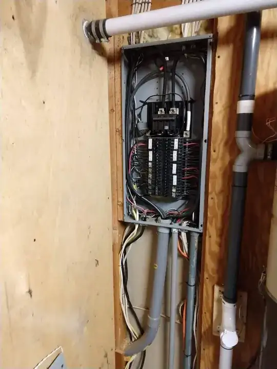

I'm considering adding a critical-loads subpanel near my main load center, in conjunction with a small grid-tie solar system, and with connection for backup power. Please critique my rationale for adding a subpanel, and help me decide on its ampacity.
Currently my main load center is congested, with only five "half spaces" (half of one panel "space", good for one 120 V circuit, or half a 240 V circuit, when using Siemens "space saver" breakers). Furthermore, this is before I connect the photovoltaics (PV) inverter and before I provide means for connecting backup electrical power.

  • How far from the floor is the existing main breaker's handle, and how far from the floor is the bottom of the current breaker box, for that matter? – ThreePhaseEel Jun 15 '20 at 23:33
  • Bottom of current load center (enclosure) is 45" above floor, mian breaker handle is 63" above floor - overall it's 30" high. New one would probably be 36" high. – RustyShackleford Jun 16 '20 at 00:45

  • The biggest issue, I think, is that pipe? in front of the panel...it's already in the clear working space, and is just going to be worse with a taller panel... – ThreePhaseEel Jun 16 '20 at 11:38
  • It's a vacuum-cleaner exhaust. If I align the top of new panel with old one, it'll be no more obstructive than it is now. Though the bottom of that 225amp panel would then be 33" above floor (dunno what the minimum is). The pipe could be raised at least 6" without too much trouble. I actually aligned it with top of panel on purpose, figuring it'd be less in the way there, than if it blocked access to routing romex coming down from the attic. – RustyShackleford Jun 16 '20 at 17:36
