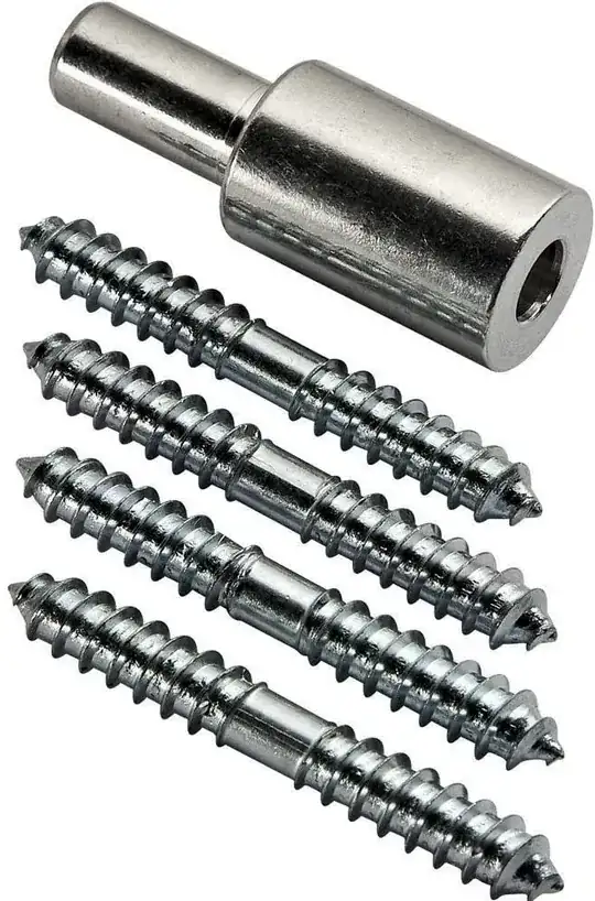

John C
Rockler (and Amazon) sell drivers for dowel screws. https://www.amazon.com/gp/product/B004SMFFCE
