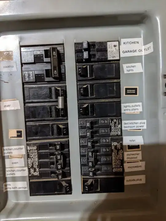

Next to my meter I have a square d all-in-one combination service entrance device with a service disconnect breaker and a sub panel breaker that must be going to my indoors panel, see attached images. I'd like to add a 15A or 20A breaker for an additional circuit close to the outdoors disconnect panel. Can I do it?

square d all-in-one combination service entrance device sticker square d all-in-one combination service entrance device service disconnect sub panel indoors panel indoors panel cover

Indoor panel
The indoor panel is another 16/24 (16 spaces with 8 spaces allowed for double-stuffs). Now that you know what to look for in the panel labeling, see a problem?
The spaces allowed for double-stuffs are on the bottom half. Yet, there's one in the upper right. Doesn't belong there.
That panel takes Murray (now Siemens) breakers, and they all look correct for the panel.
