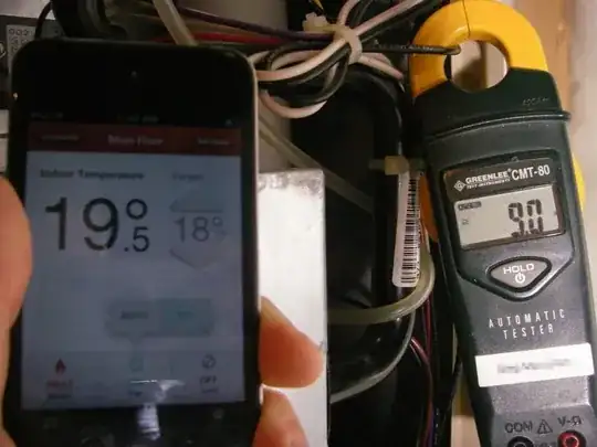

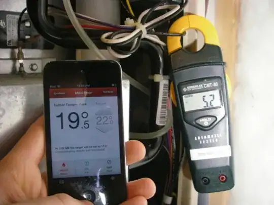

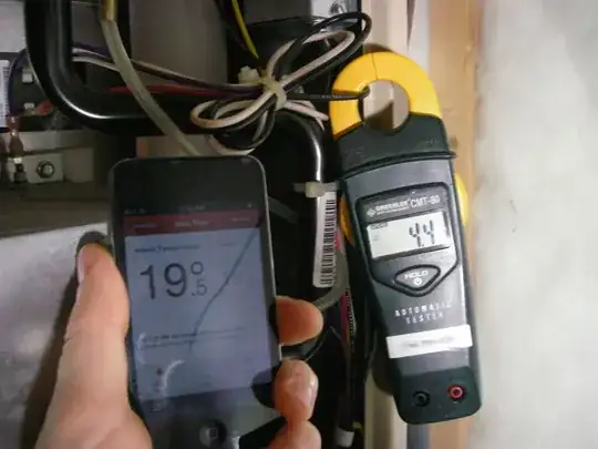

I've been using the fan on my furnace much more recently, so I was curious about this as well.
I have a Luxaire G9T100014UPC13C natural gas furnace that is about 9 years old, and a Current Innovations CI300E-WIFI thermostat (which I'm controlling from my iPod).
I'm measuring the overall power use of the furnace -- right where it comes into the cabinet.
My ammeter doesn't have the fastest response, but on startup it is measuring as high as 23A.
When the furnace starts up fully (including gas firing), it is drawing about 5.2 A.
furnace on - 5.2 A draw
When I turn the temperature down, and it goes back to only running the fan, it drops slightly, to 4.4 A.
fan running after furnace turns off - 4.4 A
Now, I am not quite sure how this works out. If I wait until it turns off, and then set the fan to 'On' (instead of 'Auto'), it draws around 9 A.
fan only - 9.0 A
I suppose it's possible that while I have it set to 'Fan On' it runs the fan at a higher speed than it does normally, but it certainly doesn't feel like it. I let it run for 10 minutes before measuring and it was still around 5.2 A, and have repeated this a couple of times a couple hours apart just to be sure (which is why I took pictures the second time). Aside, anyone have any idea why it's so different while only the fan is on vs gas firing?
