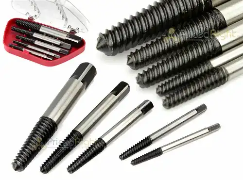

The tool designed for the job is a screw extractor
You can get these from most hardware outlets. They're handy to have in your toolkit.
Here's a detailed explanation:
https://www.wikihow.com/Use-a-Screw-Extractor
There are plenty of videos online, just search your favourite video site for screw extractor
    I don't think they would make them if they didn't work, but I have never been able to get one of these to work for me. – BlackThorn Jan 04 '21 at 23:47
