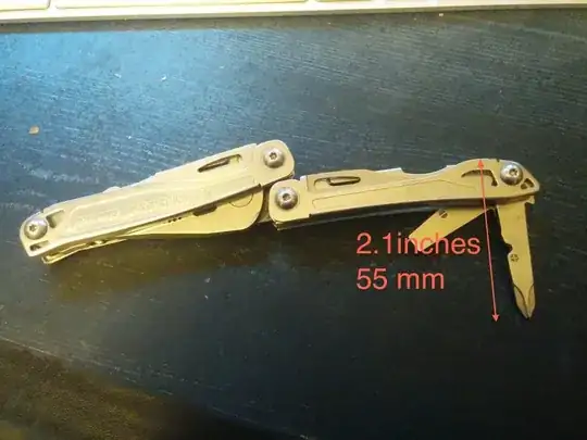

Here are a few solutions that are actually usable if you need to improvise. They are clearly not optimal, but it would certainly have helped me at the time I asked the question. I didn't own a multi tool back then. T he four solutions are based on Leatherman multi-tools (Sidekick and Rebar) in this specific case.
Leatherman multitools are sometimes sold with a flat carabiner which can drive bits.
enter image description here enter image description here enter image description here enter image description here
