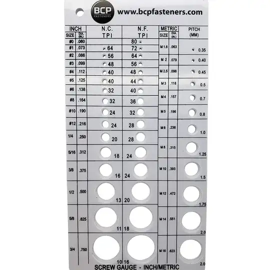

A thread gauge is not tapped. A tapped gauge is attempting to show both size and threading, and can be limited by being too thin to correctly discern close metric/inch threads, for instance.
A thread gauge lets you worry about size, while it concentrates on accurately determining threading. Of course, you need to buy one that's not a hunk of poorly made junk...

Are you saying one of these is too expensive and not accurate?

  • [Or one of these.](https://www.amazon.ca/ChgImposs-Imperial-Whitworth-Industrial-Measurement/dp/B07J9V9JTK/ref=asc_df_B07J9V9JTK/?tag=googlemobshop-20&linkCode=df0&hvadid=337141405823&hvpos=&hvnetw=g&hvrand=12669542926222323967&hvpone=&hvptwo=&hvqmt=&hvdev=m&hvdvcmdl=&hvlocint=&hvlocphy=1001801&hvtargid=pla-795985503346&psc=1) – canadianer Jan 19 '21 at 16:18
    I am, yes (wrt inaccuracy). The plastic ones wear over time due to mis-fittings and lose accuracy, assuming they're even accurate to begin with. I can't claim to tested every (more expensive) metal gauge on the market, but am definitely wary of the prospect of spending money several times over in search of a gauge that actually produces correct results (and continues to do so over time). @canadianer's recommendation definitely worth exploring though. – bjsdaiyu Jan 19 '21 at 17:06
    A metal version would be much more accurate and durable. For example: https://www.amazon.com/Horizontal-Gauge-Thread-Checker-Metric/dp/B00OM1HUJ2/ – computercarguy Jan 19 '21 at 23:31
  • Most hardware stores I've seen have something like this mounted to a shelf near where they sell nuts and bolts. So if you can bring one with you to test against it, you don't need to purchase your own. – Darrel Hoffman Jan 20 '21 at 17:46
