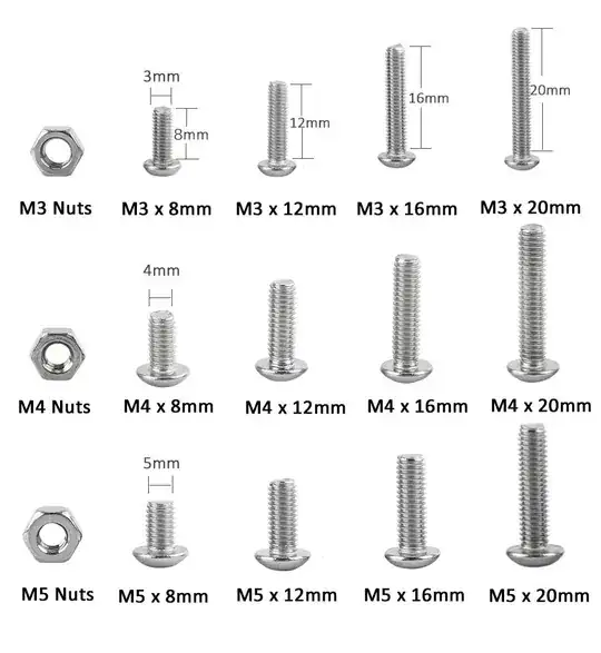

Mn for a number n means that the diameter of the screw, projected onto the transverse plane, is n milimeters - including the threading.
The "M" stands for "Metric" (as opposed to British-imperial units).
Illustration:
Remember the Mn designation does not tell you what the length of the screw (along its axis) is.
