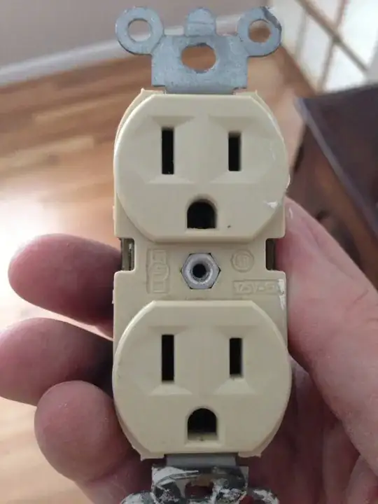

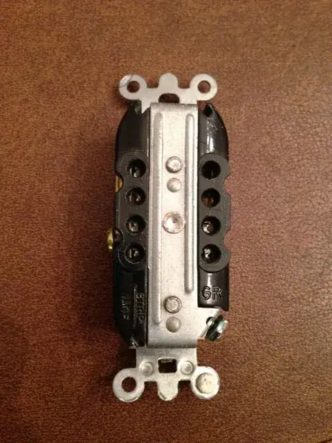

In my home (built around 1970), I found a bizarre outlet when replacing the dated old ones. The front is your standard duplex, but on the back there are holes for 8 wires (4 hot, 4 neutral) plus the ground. Into the box, there are 4 pairs. Is there a name for this type of outlet, so I can try to find a replacement? I don't want to try to jam them all together in a standard outlet and create a hazard!
The original outlet says max 15 amps, 125v. Please see pictures below.
EDIT: Replaced front pic with sharper image, added pics of hot and neutral sides.
Back of original outlet
Front of outlet

  • Is there a company logo/name on the device somewhere (maybe on the front, the image is a bit blurry)? – Tester101 Dec 26 '12 at 12:19

    Not uncommon at all. Some higher end Hubbel and Pass & Seymore outlets are configured with that many back wired holes. They are typically compression fittings tightened by the side screw as opposed to a barb spring. – shirlock homes Dec 26 '12 at 12:33
  • I don't know of a specific name, but I know that the Altus SSRE-6-WH10 (decora style) receptacle has the same pinout your pictures describe. – Matthew Dec 26 '12 at 15:46

    @Paul: The connecting tab on the hot side and neutral side are both intact. I added pics of both. I retook the front image, and it is sharper. I do not see any names or logos aside from the UL and CSA logos, and the 125v/15a max text. On the back, I see "CU" in a circle and "AL" in a circle with a slash through it. Additionally on the back, I see "NOM 057". Those are all stamped in the metal on the bottom side. On the top side, stamped in the metal as well, I see "LEVITON MEXICO, CU AND CU LLAD WIRE ONLY". So, it is indeed made by Leviton. – themidnightwill Dec 26 '12 at 21:03
  • "CU" means you can use copper wires to connect to the device. "AL" with a line through it, means you can't use aluminium wire to connect to the device. "NOM" (Norma Oficial Mexicana), is a Mexican certification which is required on products that may be used in Mexico. – Tester101 Dec 28 '12 at 14:12

Leviton has a useful web page for device lookup here. Using that, you can find the replacement receptacle is a Leviton 5252. Most shopping sites (like amazon) don't show the back, but a Google image search with that model number does show several pictures of the back.
