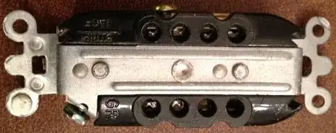

Use devices as connectors
Another option, is to use unused terminals on devices as splice points. For example, you might have a switch with both side and back terminals. Using the back terminal as a splice point, is an acceptable way to extend the circuit. In fact, some industrial grade receptacles (like the Leviton 5252 Series) offer 8 clamp style terminals on the back of the device.
