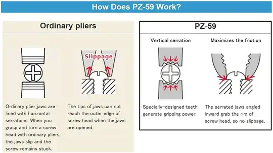

Engineer (a Japanese company) makes a series of pliers specifically designed for screw removal, called the ネジザウルス ("Nejisaurus," lit. "Screwsaurus"). One example is the PZ-58 (English page, Amazon US page). These have ridges or serrations oriented perpendicular to most pliers which allows a better grip for rotating the gripped item around the lengthwise axis, as can be seen on the right in the image below (though to me those "slippage" arrows seem to be pointing in the wrong direction).
There are plenty of video reviews of the PZ-58 on YouTube; this one happens to be the first I found. It points out that the ridges do seem to flatten quite quickly, so it's hard to say how well this will work long-term. But perhaps other manufacturers make similar pliers.
(I have no affiliation or connection with Engineer beyond owning some of their tools. These include a PZ-58, though I've not used it enough to render a serious opinion on them beyond, "from brief use they seem to work better than regular pliers for screw extraction.")
Nejisaurus grip
