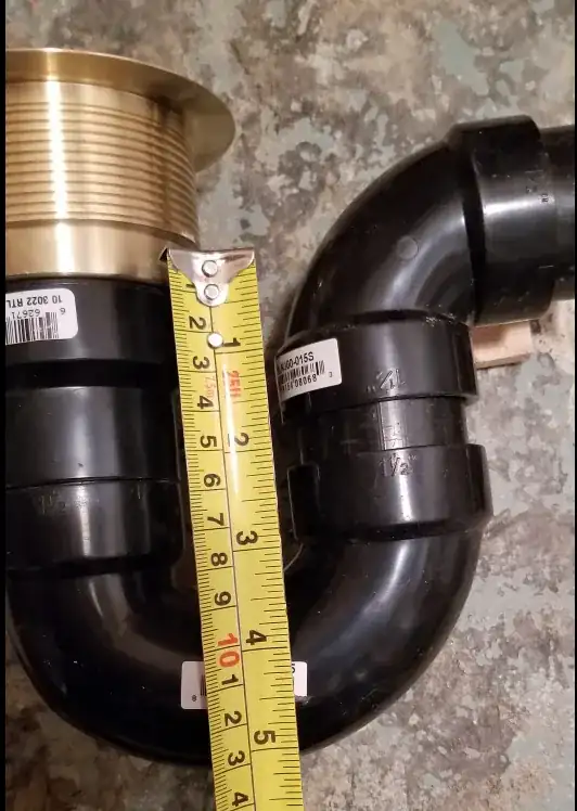

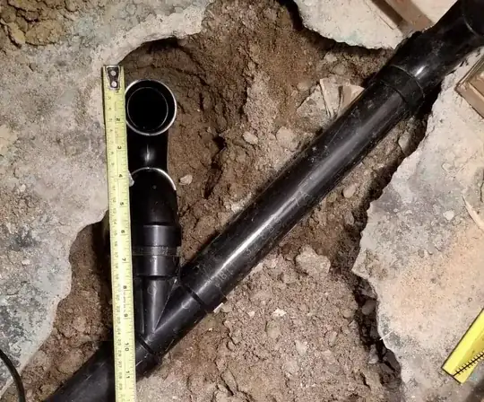

Update2: OK here are the result of this evening attempt to make room for a lower trap and bigger seal depth
Final result with the drain flush with the floor but there is room to move it higher when the shower base gets in its place enter image description here
Here is the overall height of the assembly enter image description here
And here I am making it easier to measure the seal depth by positioning the tape as needed enter image description here

  • You need to place the reducing *bushing* (*not* the bell reducer) **directly** into the drain outlet (where your picture shows 2" pipe), then you can run 1 1/2" pipe from the trap up to the drain. See my answer. – Jimmy Fix-it Mar 23 '21 at 21:07
  • not possible as the reducing bushing is short (3/4") , shorter than the rubber gasket that is 1" tall – MiniMe Mar 23 '21 at 21:11
  • Hmm, what is the vertical distance of the violet "trap weir extender"? I believe that the maximum total water height in a trap is 4". You are raising the weir height by altering the trap that way. – Jimmy Fix-it Mar 24 '21 at 00:09
  • Please see the Udate2 pictures – MiniMe Mar 24 '21 at 01:06
  • looks like you'll be OK, I think the 4" is from the top of the lower trap bend, to the "overflow point", i.e. the bottom of the trap outlet. Looks like you are under 4". – Jimmy Fix-it Mar 24 '21 at 01:36
  • Yes thank you.Using a bushing does not work as the bushing has the inner truncated cone like shape on the wrong side favoring the flwo from 1.5 to 2". The coupler instead is built the other way around facilitating a smoot teansition from 2" to 1.5" – MiniMe Mar 24 '21 at 02:42
