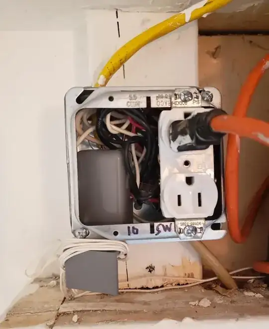

Here is my implementation of the Accepted Answer.
At the top of the closet, a two-gang box with a raised ring is just right for the relay, a switched outlet, and two cables. The relay fastens cleverly to a knockout with the sensor leads entirely on the outside. I've ordered a half-blank cover plate to finish this. I had to think carefully about which knockouts to use so that everything would fit. I put the outlet on a pair of long pigtails so I can easily remove and reorient the ring depending on which way the PSU (which I have not yet bought) dangles from the outlet.

  • Don't the high (120v) and low (5v/12v) components need to be separated in the box to ensure no mains voltage can hit the LV stuff in case of a short or other accident? – FreeMan Sep 30 '21 at 16:55
    They are separated. The relay provides separation internally, the relay body sticks out through the knockout and the sensor wires exit there. It's a thoughtful [clever design](https://www.functionaldevices.com/support/downloads/datasheet-generator/?SKU=CLC106). – jay613 Sep 30 '21 at 17:21
  • Ah, separated by dint of being inside a plastic box protecting all the LV stuff from wayward HV stuff. Got it. – FreeMan Sep 30 '21 at 17:23
    That grey plastic baffle at the bottom, is both the locking mechanism for the relay in the knockout, and also if the box were installed inside a wall or ceiling, it is designed to cover the hole in the plaster that you cut to pass the sensor wires through. Really thorough. – jay613 Sep 30 '21 at 17:25
