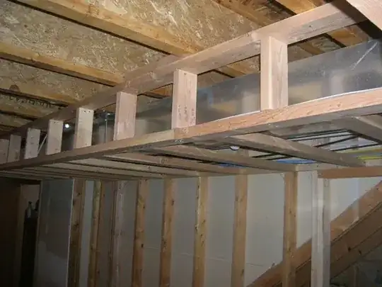

In your scenario, I would build a bunch of "soffit ladders" and run them perpendicular to your floor joists.
You should use 5/8 drywall. I would put just one layer. 2 layers is unnecessary unless you have a permit and the building inspector requires it. You can then space the ladders at a max of 24" on center, 16" if you wanted to over do it. Normal 2x4s will be fine.
If you run into a pipe or any obstruction, just stop the ladder before and continue it after or build the ladder around the pipe and have it run through the ladder.
As long as all edges of the drywall can be secured and you can fasten every 24 inches within the drywall, you will be fine.
In the below picture you can see the vertical soffit ladder, I wouldn't worry about running 2x4s between the ladders, unless the ductwork prevents you from putting a ladder on the 24" mark.

    I would upvote this question if it addressed how to suspend things from an engineered joist and how particularly that was done in the photo here, because it's not obvious. You need to follow the manufacturer instructions of your specific joists and usually need to do some blocking. I see one block in this photo, running between a pair of flanges, but can't tell how it's attached or what it's doing. – jay613 Nov 10 '21 at 19:17
  • @jay613 can you provide a reference to support "usually need to do some blocking"? It seems to me that for boxes and light-weight framing (e.g. garage storage and bike racks ...) *no* blocking is required, and that the above ladder frame is correctly attached to the flange. – P2000 Nov 11 '21 at 21:39
  • True I cannot substantiate "usually". I have an example [here](https://www.redbuilt.com/wp-content/uploads/2020/08/Metric-I-Joist-Coversheet_594x420.pdf) where I infer up to 250 pounds can be supported directly from the bottom flange without documented blocking technique. My (one) previous experience was very similar, though I do not remember the figures. Assuming above ladder is attached to multiple joists they are probably supporting much less than 250lb each. As I said in first comment, I cannot tell from photo how they are attached. 2 for 2 is "usually" enough for me. :) – jay613 Nov 12 '21 at 13:02
  • @jay613 yes that sounds about right, I quoted 500lbs/5ft from Weyerhauser (see my answer). They have a tech note on it. Too bad this thread has gone practically silent, it's a good topic. – P2000 Nov 12 '21 at 14:51

You can attach point loads to the bottom flange of an I-joist. For instance, Weyerhauser specifies a load of 500lbs every 5ft. This is for a static load, which is the case for suspended ceiling. (For dynamic loads and loads that move, e.g. punching bags, it is recommended to apply blocking, engage the joist's web and install a brace to span two joists)
Attach joists to I-beam via 2x4 or 2x6 vertical stubs. Attach stubs to the bottom flange of the I joist. Attach joist to side or bottom of stubs. Careful here: you need to calculate the load per stub and thus the sheer strength or pull-out strength required of the fastener. The larger 2x6 stub will provide more room for more fasteners. Should toe-nailing or tow-screwing to the bottom be problematic, you could install blocking that engages the web and rests on the bottom flange, and attach the stub sideways into the blocking.
