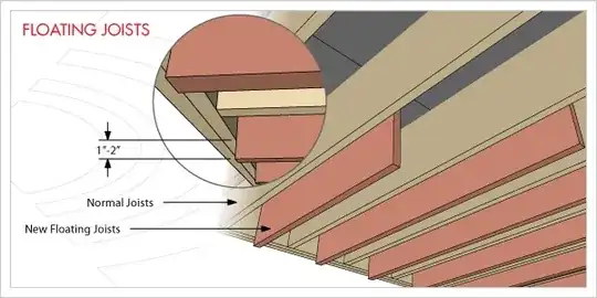

I'm installing a new ceiling in the kitchen of the bottom unit of a multi-family home. The house is quite old and uses 2x8 (actually 2"x7.5", not 1.5"x7.5", due to era of lumber) over a 12 foot span, which experience more deflection than is ideal but is certainly acceptable. This does create more transfer of impact noise (foot steps, dropping things, etc). I have isolation clips for the ceiling furring (http://www.kineticsnoise.com/arch/isomax.html) but, now that we're not installing recessed lighting, I'm considering adding a second, separate set of joists to hang the ceiling from.
Problem
What is the minimum joist depth and maximum spacing needed for new joists that support only a ceiling (since there are separate existing joists carrying the load of the floor)?
My calculations for two layers of 5/8" drywall/blueboard and some mass-loaded vinyl come to just over 5 lbs/sqft. There will be additional weight in veneer plaster and a trivial amount in light fixtures. All span calculators I can find accept a minimum of 10 lbs/sqft of live load and an additional 10 lbs/sqft of dead load. This situation seems to me to be around 6-7 lbs/sqft of dead load and essentially no live load over a 12 ft span. Trying to figure out if I can get away with 2x4s or need 2x6s or can cut 2x6s down to 2x5s, etc and whether I can space them every 24" or need to stick with 16". Not so much a matter of cost as of space for other sound proofing materials and considerations. Deflection concern in this case is to avoid veneer plaster cracking.
To clarify, this image is roughly what I'm planning for, where the red joists are to be added and whose dimensions I'm trying to determine.

  • @Chris Yes, reduction of impact noise as you say. This is about the ceiling weight though since I'm talking about adding a new, separate set of joists (staggered between the existing joists that support the floor above) to carry the ceiling weight only and not attaching the ceiling to the existing joists. – Steve Jul 08 '16 at 00:25
  • @Ed That's my proposal here is new 2x's that have no contact with the existing joists or upper floor. I'm looking to calculate the smallest depth I can use to avoid contact with the insulation as you say. – Steve Jul 08 '16 at 00:27

By the way, your loading seems a little light:
  1. two layers of 5/8” gypsum board is 6.25 psf,
  2. hat channels is about .5 psf,
  3. new 2x6 joists at 16” oc is 1.5 psf,
PLUS, I would add:
  1. rock wool insulation at 4” at 2 psf,
  2. 1/2” fiber sound board at 2 psf and misc. (lights, etc.) at 1 psf...
for a total dead load of 13.25 psf. (Even the crappiest grade of 2x6 at 16” oc will support that for 12’)

Old I know but worth it: Lee Stan has the right idea but, To answer your question more directly - ****The joists should be AT LEAST 2x6 and can be mounted or hung lower than the rafters using joist hangers.

I've seen a 2x4 drop ceiling with a 14' span and 1/2" drywall below a bedroom, and that seemed fine, but the deflection calculators online tend to indicate that 2x4's might be marginal, and 2x6 should be used, especially if they are only hung at the ends and no support along the span, as might be needed to reduce sound transfer. Either 16"or 24" centers, whichever is more convenient.
If it were my project would probably do Roxul against the subfloor above, hang new 2"x6" on 24" with joist hangers and bracing between the new joists, then resilient channel and 5/8" or 1/2" drywall. Electrical boxes can be covered by Roxul as well, or more sophisticated sound deadening membrane. Also, any penetrations in the floor above for pipes should be sealed around with something like a latex caulk.

After reading more of what you want I would use 2x6" for the span and 16" centers with hangers this would be enough to support the ceiling and even recessed lighting like this. hung at the bottom this will provide the isolation you are looking for. We use these hangers for supporting overhangs with sheeting and roofing all the time and for decks. I would hand select the boards to get the best quality #2 or better but if you can afford #1's because today's lumber is not of the quality it was 20 years ago because of the smaller trees.
  • Thanks for your consideration of this. I agree that 2x6 at 16" will definitely work. Looking to understand what the minimum height (possibly less than 6") and maximum spacing (possibly 24") is and why. – Steve Jul 08 '16 at 20:06
  • You may be able to go to 24" centers but I have had trouble with 1/2" sheet rock on 24's 5/8" works better but is much heavier to hang. Considering it will only be 1 or 2 more boards going with 16" OC the cost and ease of hanging the Sheetrock would have me going with 16" OC. Remember you will have a butt seam in the center. I usually put a nailer up for this always on 24" but with a very cheep job on 16's the center nailer is left out. – Ed Beal Jul 08 '16 at 20:55
  • Re:16" OC, I can do that for weight, but the steel furring is attached to the joists via clips only every 3-4 ft along the furring and there is 2 ft between the furring strips. Shown here as the 'staggered layout' [link](https://isostore.com/guide/how-to-install-resilient-sound-clips/). With 16 O.C. can I do 2x5 or 2x4? Do you know of a resource, reference, or standard calculation that can be done to find this? – Steve Jul 08 '16 at 21:11
