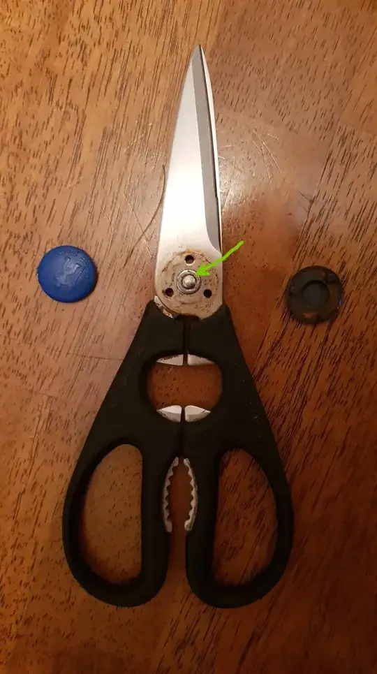

I have a pair of J. A. Henckels kitchen shears that look exactly like this:
The joints are covered with a blue cap on both sides.
I sharpened them recently, but they still don't cut well, and I realized it was because they weren't tight enough.
I tested it by holding it upright, opening one side at a 90 degree angle, and then dropping it to see if the blades would catch, something like what is described here: https://www.darkstag.com/scissor-shear-tension/

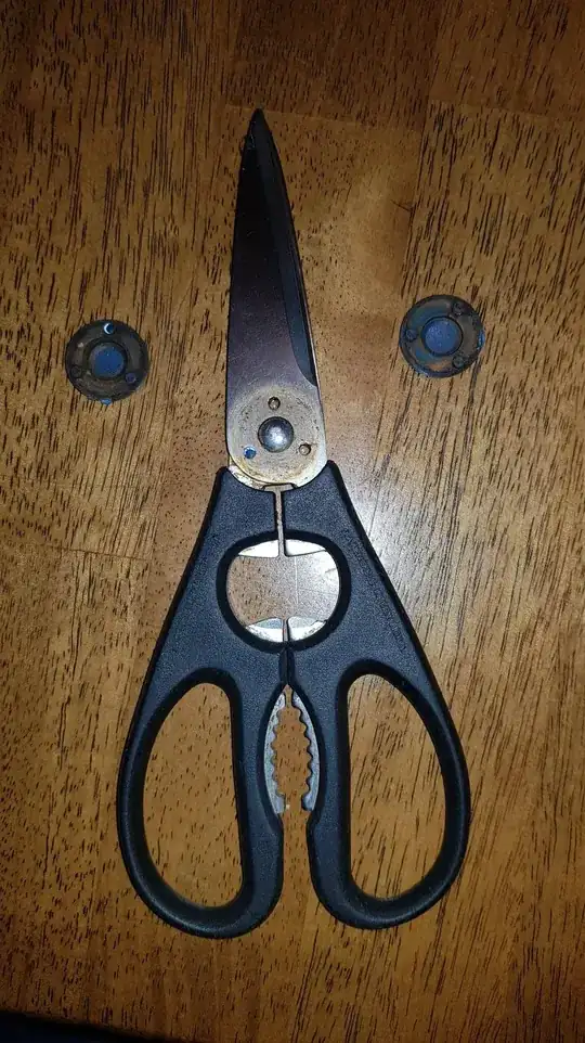

So I removed the blue cap on each side of the joint, and it looks as such:
What kind of joint is holding the blades together? It does not seem to be a screw, but I am unsure. In the 3rd image (the reverse side of the scissor), there appears to be a washer (pointed at by the green arrow) in the joint.
I tried hammering the pivot together, but it only seems to slightly reduce the gap between the blades. Should I use more force, or is there another way that the tightening should be done?

Looks like a pretty normal rivet-and-washer (or rivet-and-burr) joint.
Careful work with with an anvil (or anvil-substitute, such as a sledgehammer head) and a ball-peen hammer (moderately small) will tighten it up. Support one side on the anvil, and tap the other with the ball-peen hammer (or, I suppose, some other sort of hammer, but the ball-peen is better than a flat one for the purpose.)
Repetition rather than great force is the generally safer approach, since there's no easy way to loosen it if you give it a big whack and they become too tight to close. Each tap slightly deforms the metal, and many repeated taps will move metal in ways that one huge bang won't.
