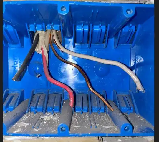

I opened the box where the previous outlet was and found 10/3 wire w/ground (picture below), even though the dryer outlet on the other side of the wall and the one we had removed are both 10-30 receptacles, and so ungrounded (home was built in '92). Testing these wires confirmed two hots at 120V each, one neutral and a dead ground. Odd thing is, the bare copper wire which should be the ground wire is wired as neutral, and the white neutral wire is dead. A no-contact voltage tester indicates the bare copper has live but low voltage present. With a DMM, I get 120V from either hot to this wire, and nothing from either hot to what I thought should be the neutral. Is this normal, or am I doing it wrong?

    Was there any protection on those cut wire ends when you opened the box up? Having bare wire like that with no protection, I'd think would be a safety hazard, even if nothing were connected to them. I'd at least put wire nuts on them for protection. Also, it looks like when they took out the previous outlet that was there, they just cut the wires, and didn't do you any favors doing that by cutting them so short. There's probably not enough wire length in there to even make pigtail connections, as I believe code typically says that one needs a minimum of 6" of wire in the box. – Milwrdfan Jan 21 '22 at 04:53
    *"With a DMM, I get 120V from either hot to this wire, and nothing from either hot to what I thought should be the neutral. Is this normal, or am I doing it wrong?"* No, you're not doing it wrong - this is why 10-30 outlets are dangerous and illegal now. Also why tapping it to feed a 14-30 is equally dangerous and illegal. – J... Jan 21 '22 at 14:02
    @Milwrdfan; Totally agree with your comments and no, there was no protection on these wires. When i pulled the faceplate off this is exactly how it looked. i know, very dangerous. i have yet to pull the faceplate off the dryer receptacle on the other side of the wall but I already know I'm going to cringe when I see how he tapped the line. that's why i plan to just yank all this out and run new wire for the dryer too, upgrading the receptacle/circuit in the meantime. – KM001 Jan 21 '22 at 16:46
The old wiring is 100% irrelevant to this, since you know it isn't large enough for anything more than 30A. So ignore all that and the plastic box, etc. Except that you should replace the existing 30A dryer 10-30 receptacle with a 14-30 receptacle, which will be easy since the new subpanel will have ground going back to the main panel. You will need to change the dryer cord and remove the neutral/ground bond on the dryer.
Yes, that's just the kind of horky nonsense we see anytime NEMA 10 is involved. In fact it's a bit of a surprise to find a groundless NEMA 10 in 1992, since groundless #10 wires were all but gone from the market. Some people installed 10/2 w/ground, and abused the ground as neutral; but that has always been forbidden (and thus, NOT grandfathered). Once old stocks of 10/3 "without ground" ran out, you were to use 10/3 with ground and simply not connect the ground if using a NEMA 10-30.
However, one thing was legal: having multiple outlets on a 30A circuit.

First of all, if that dryer outlet was for a 220v only dryer, that configuration would be correct. They probably just only had that wire type available. You only need the neutral connected if there is a 120v requirement as part of your device. Otherwise 220v plus ground is all that outlet needed. And it would be absolutely correct to read 120v between each leg and ground. Remember that your neutral wire is grounded at your main panel in standard configuration, so with no current flowing they will measure about the same.
