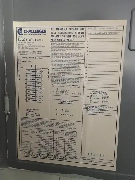

I am trying to determine what GFCI breaker to use for a 20A MWBC in an old Challenger panel that requires Eaton Cutler-Hammer BR breaker replacements. I have found at least three models that appear to be potential fits: GFTCB220, GFTCB220CS and GFCB220. Is either one of these good or do I need to get a specific one? I do not currently have any Challenger GFCI breaker on my panel, so I can't look for a fit based on the model replaced. Here is a photo of my panel label if it helps
