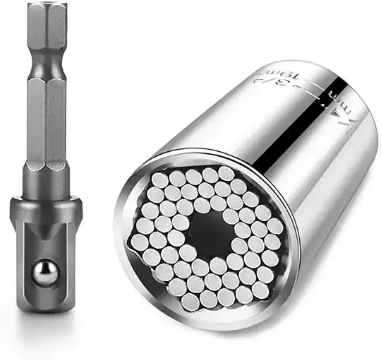

It almost looks like a T head bolt, but not exactly. Due to irregular size, I would recommend a universal socket; those are the sockets with all the little pins in them that are pushed out of the way to confirm to any shape.
Example of said a universal socket; you would want to get one appropriately sized for your need.

    @isherwood I was thinking maybe an appropriately sized wing nut socket would work too, but since those are normally hollowed out, I thought it might break the tool. This is the closest tool I could think of that might work. – UnhandledExcepSean Jun 09 '22 at 18:42
  • I suppose if you applied this one over to the side it would grab. – isherwood Jun 09 '22 at 18:47
  • This looks far too wide to fit in the tight space in the photo. If they make one about half the diameter of that it might work? – Darrel Hoffman Jun 10 '22 at 17:26
  • @DarrelHoffman I wasn't recommending a specific size. The photo was just an example of the product I had suggested in case they were unfamiliar with it. – UnhandledExcepSean Jun 10 '22 at 17:41
  • Yeah, just saying, I've seen these before, but I don't know if I've seen one that's much smaller than your example. I suspect it'd be a bit too delicate if scaled down much more than that. – Darrel Hoffman Jun 10 '22 at 19:12
