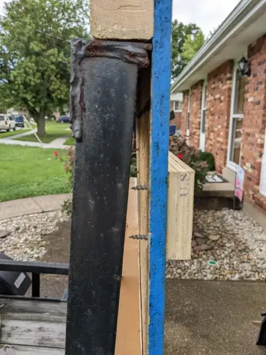

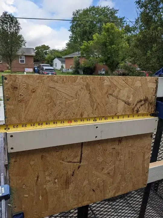

enter image description here This piece of 3/4" plywood is held only to the 7/16" OSB with 6 screws. I weigh 175lbs and basically did a pull up on it. I'm now confident that fastening to a metal stud every 2' and one set of screws in between I'll be able to hang just about anything I'd need to.
