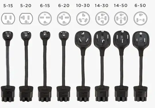

How do we get other 'speeds' on a travel EVSE?
Like this if your travel EVSE sells other dongles.
See, each dongle plug has a microchip inside. The microchip says "Hey, I'm a 30A plug!" and the EV says "OK, I'll draw the right amount of current for that". EV charging is slick. So if you install a 20A circuit just install a 20A socket and order that dongle plug. Easy peasy.
(note that using "cheater cords" with travel EVSEs is a recipe for disaster.)
Another way is to go with a wall EVSE, which is either set to the appropriate amperage at install time, or is hardwired that way from the factory coughCrippleCreekcough. It automatically tells the car "Hey, you're on a 20A circuit".

  • @isherwood Can you link to a specific one of these "just ... a cord"? Yes there are some EVSEs where the box of electronics is small enough that it's a lump near the plug that's allowed to dangle and doesn't require wall-mounting (for example, the Bolt's "Dual-Level Charge Cord") but despite the name they *are* actually an EVSE. They're not just dumb wires. – nobody Nov 02 '22 at 22:56
  • https://shop.tesla.com/product/gen-2-nema-adapters – isherwood Nov 03 '22 at 02:11
    @isherwood That’s not a cord that plugs into a car. It’s a replaceable plug for an EVSE. By the time somebody buys all the parts needed to use it (50A GFCI, socket, etc) they’re spending as much as or more than a hardwire EVSE. – nobody Nov 03 '22 at 02:43
