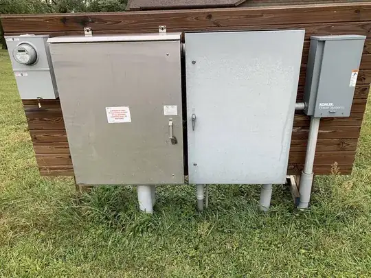

Photos:
Wire to shop panel
Wire to shop panel

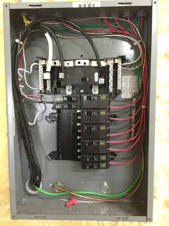

Shop Subpanel
Shop Subpanel Shop Subpanel breakers Shop Subpanel label
Main Panel
Main Panel Main Panel Breakers

That's exactly the situation you describe in comments: "The wire from the main panel comes into the shop building, then splits off (Polaris connection in the large gray box at bottom) into the 100amp fused solar panel and the 150amp sub panel in the shop serving the loads."
I see breakers on all 3 sides - a 200A at supply, a 100A on the solar, and a 150A on the shop panel. I see no reason you can't enlarge the shop breaker to 200A - but it does need to have one for this to work.
So we have gained 50A of Load Calculation inside this panel by deleting the solar penalty. I don't know how much that'll help with the overall Load Calc in this panel because you say other subpanels also come off this. So you'll need to evaluate that, you're looking at the Load Calcs not me.
