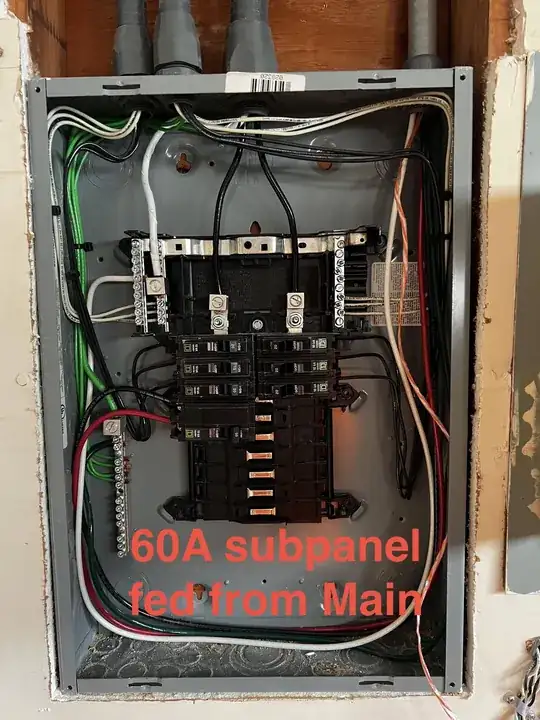

Edit: Here are some pictures. The EVSE breaker could either go in the main panel or the 60A sub panel. There are some unused circuits in the main panel: the quad in the upper left was for an electric range+oven that were removed. The middle breakers on the quad below it were for an electric dryer that has also been removed. The 50A sub panel for the heat pump could be on a smaller breaker. 100A main panel
60A sub panel
50A sub panel for Heat Pump
EVSE
Edit: Added description of all the loads on the various breakers. Main Panel Circuits description 60A Sub Panel Circuits 50A Sub Panel Circuits

    Can you post photos of your panel please? – ThreePhaseEel Nov 21 '22 at 02:55

  • @ChristianK -- can you provide us with whatever the panel directory labels say the circuits in your panels go to? – ThreePhaseEel Nov 24 '22 at 02:07
  • @ThreePhaseEel I've added descriptions of the loads for each circuit. Let me know if you need more information to figure out if there is an issue adding a 40A breaker for the EVSE. Thanks – Christian K Nov 25 '22 at 18:19
