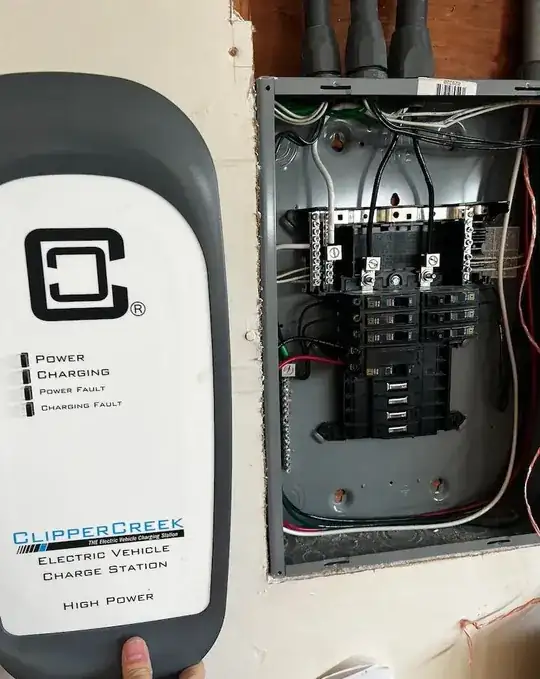

I want to figure out how to hardwire an EVSE directly into a sub-panel. I already have the EVSE (ClipperCreek HCS-40, 30A charging current, 40A breaker), it was installed previously in another home with a 14-50 plug (but I think it was meant to be hardwired given the whip).

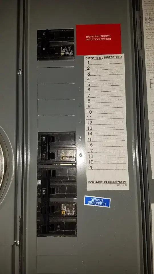

Our jurisdiction currently lets me use the 2017 or 2020 NEC. I understand that I need a GFCI breaker if I use a 14-50 outlet for the EVSE, but not if I hardwire it. The unit comes with a 3 ft whip, which appears to be PVC coated MC cable. It has 2 hots and a ground in the whip. All are 10 gauge. I want to mount the EVSE right next to the panel. If I run the whip into the panel, I do not see how I can land the #10 wires on a 40A breaker. I would rather not add a box with a bunch of Polaris connectors to transition from the #10 to #8 THHN wires.

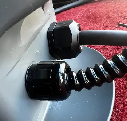

I opened up the EVSE and it looks like I could run new #8 wires to the contactor and ground bar, and then use some LFNC from the EVSE to the panel (see picture of the inside of the EVSE below). Is this acceptable, or is that considered modifying the equipment? I've seen other hardwired EVSE's where you terminate the wires inside the EVSE. I've received some very helpful suggestions in response to another question I asked related to adding the load to my panel.
What is the most direct way to hardwire this EVSE into a panel? If I use the existing whip, what type of connector should I use on the PVC coated MC?

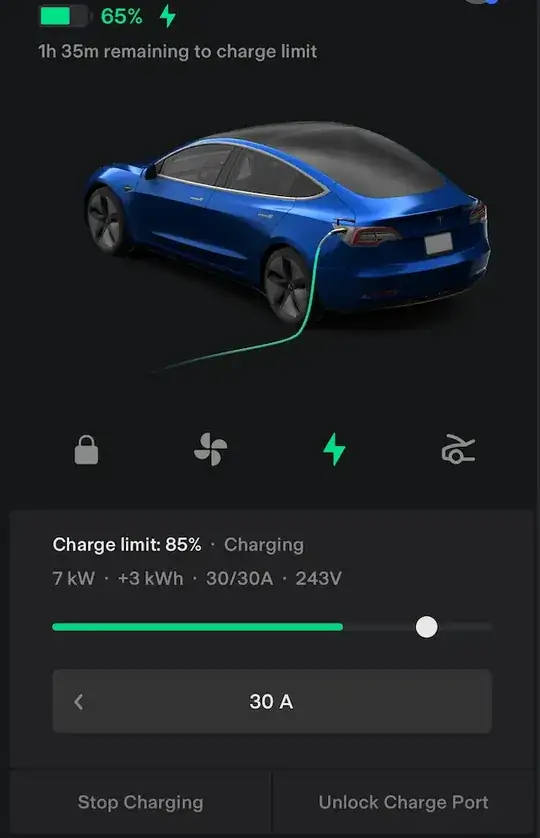

There is a lot of debate on how this could actually be a 30A unit, since the new HCS-40 are 32A (which makes sense given that this is the max continuous load you can have with a 40A service). To test this out, I temporarily wired the EVSE into a spare breaker and set the car to charge.
Below are a screenshot from the Tesla app, a picture of my clamp meter and a screenshot from recordings from my WattNode with 2 50A CT's. I think this proves that it really does not want to give me more than 30A. For those of you unfamiliar with the Tesla app, the fact that it says 30/30 shows that this is the max will draw from this EVSE.
That would be a simple matter if your panel was surface mount. Unfortunately, it is flush mount and I don't think the instructions say anything about plunging it into the innards of a wall and then burying it in insulation and drywall mud.
You're making too much out of the surface mount box (a 99 cent drawn steel 4x4 box will suffice) and Polaris connectors (honestly? Tan wire nuts will suffice.)
Just come out the bottom of the panel with 8/2 Romex and into the back of the surface mount box. Hardest thing will be finding two cable clamps fit for 8/2.
Since your panel is flush-mount you have no choice but to run some wire inside a wall. I would run 50A wire honestly, right into the back of a surface mount 99 cent corner-screw drawn steel 4x4 junction box.
Run the wire whip into one of the side knockouts - it has the fitting for that already on it. 10-32 ground screw, blank lid and a couple of tan wirenuts and you're done.
This will also allow for quick change-out of the EVSE should that be necessary, and for that matter, a 14-50 receptacle could be installed in the 4x4 box if you find yourself in a jam or simply have a friend with an RV visit. Hence my advice for 50A cable - you're only going 2 feet lol.

  • I will check the charging current to once an for all figure out if it is 30A or 32A for this model. Is it good enough to use my Klein CL220 clamp meter on one phase? – Christian K Nov 27 '22 at 17:33
    Most EVSE will charge based on a setting *you select*. That can be either done via the car or via some setting (buttons, switches or some "App" interface, depending on the EVSE) directly in the EVSE. Even if set to full (=30 or 32) you may find that at various points the actual current flow will be lower. **It doesn't matter** for purposes of this question. The factory-installed 10 AWG wires are, *by definition*, OK. And your wires (whether a short extension in the breaker panel or 50 feet through the house to the garage, etc.) have to be 8 AWG (because 30A=10 AWG is for total, not continuous) – manassehkatz-Moving 2 Codidact Nov 27 '22 at 17:56
