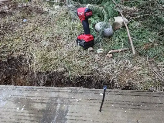

I bought a set of 12" screws to drive through two 6x6 landscape timbers.
With my M18 Milwaukee Fuel impact driver I can start driving the screw, but it reaches to a point that I can't either screw further or unscrew it.
Why would this happen? FastenMaster screws claim to not need a pre-drilled hole.
Attached picture to help visualize the situation
screw fail

    Will sometimes need pilot holes in hardwood to in screws/nails, but doubt landscape ties are hardwood. Six plus inches might just be too much, without pilot hole. It is a lot of wood to go though. – crip659 Nov 22 '22 at 01:14
    12"without pre-drilling seems a bit sporty. I fastened some 2X PT lumber to dock pilings using 6" stainless steel, self drilling screws. I pre-drilled the 2X so the screw only had to drill 4" into the piling. And even that was getting slow at the end. – SteveSh Nov 22 '22 at 01:50
    "*Why would this happen? FastenMaster screws claim to not need a pre-drilled hole.*" Marketing lies. Wood doesn't disappear just because you want it to. – DKNguyen Nov 22 '22 at 16:14
    Probably they're fine into balsa or soft pine. ;-) Those 6x6s are even hard to drive a big nail into. – Spehro Pefhany Nov 24 '22 at 00:11
    Friction and "stickiness" is probably the problem here. As the screw goes in it collects sap from the wood, creating a sort of glue that makes it harder and harder for the screw to turn. Sometimes a dab of oil or grease on the screw can help eliminate the problem. – Hot Licks Nov 24 '22 at 23:27
  • That's a baby clacker (impact driver), 1/4". You need big daddy: 3/4". The ones you can take car tires off with. [High Torque 3/4-inch Impact Wrench](https://www.google.com/search?client=firefox-b-1-d&q=High+Torque+3%2F4-inch+Impact+Wrench) **They DO NOT need pre-drilled holes. *You* need a drill capable of driving them.** If you're building a deck or laminating some LVLs w/o one of those, using those screws, then have fun. – Mazura Nov 25 '22 at 04:28

If the pieces of wood you are drilling are not tightly pinned/clamped to each other, and are able to move around relative to each other while drilling, that is going to cause the screw to bind up and overwhelm your driver.
Myself, especially in treated I would use lag screws (basically bolts with wood threads). Lag screws of this length are 1/2" diameter. These must be pre-drilled to full size through the first piece, and to the specified undersize (3/8"?) into the second piece. They have a large hex head (probably 3/4" hex) and are run down with a normal socket wrench, or impact wrench for the hand-tool-impaired.
To drill them I would start with a tiny 1/8" pilot hole, then use a wide 1", 1-1/8" or 1-1/4" drill (whatever will leave clearance for your drive socket) down, to allow the head and a washer to be recessed into the wood and the head to be flush. After that countersink is done, then drill the main 1/2" hole.
1/2" lag bolts will do a much better job holding than those dainty little deck screws. I don't know what your service loads are.

You are working with pressure-treated wood.
That is a whole different story than dry wood.
Pre-drill the first 6 inches to make it easier for the driver to do its job.
I also do not see the self-drilling notch on the screws, thus would question the statement of no pre-drilling required.

When screwing in pressure treated wood (it is moist inside), The fibers are forced out of the way, but they flex back into the original position thus tightening the grip around the screw - i.e. chocking the screw.

Pre-drilling is, more or less, for normal screws. A normal screw cannot cut into the wood, it merely pushes it out of the way. But you're buying the nice, pricey screws. Drilling? Where we're going we don't need drills! Just grab your impact driver and go to town! That's why you paid $20 for 12 screws, right?
I rather like Harper's point about lag screws. Lags do far better in this situation, but it's worth talking about something else important (screw or lag): technique. Most likely you put the screw in your driver and started driving. There's two things to keep in mind on screws of this type:

That's just too much. I would predrill through the first 6x6 at the full width of the screw. Then predrill partway into the second with a narrower bit, so that the screw can fully grip into the second 6x6.
Just because you don't have to predrill doesn't mean you can't predrill.
Looking at the linked product, only the last few inches have threads. Since the upper part that will be inside the first 6x6 has no threads, it won't grip whether your predrill or not, so predrilling has no downside except for a little extra time.
I think the problem is that as it goes through the first piece of wood, and reaches the second, it tries to pull the second up to the first, thus binding it all. Were it just one piece of wood, it would probably carry on until it was buried - try it on a similar piece.
That's the reason. The solution is to pilot a hole through the first piece. Let's face it - you're trying to pull the two together, so as the screw tightens into the second piece, it needs to be free to slide inside the first, which it will do inside a hole just wide enough to allow it to slide. If it can't, then it binds, and the two pieces will never be squeezed together, which is the object of what you're doing.
And with 2 off 6"x6" timbers, there's a good chance when it's all tight, the sharp points of 12" screws will be sticking through the other side. Not a sensible idea, I think...
