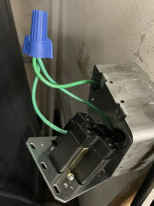

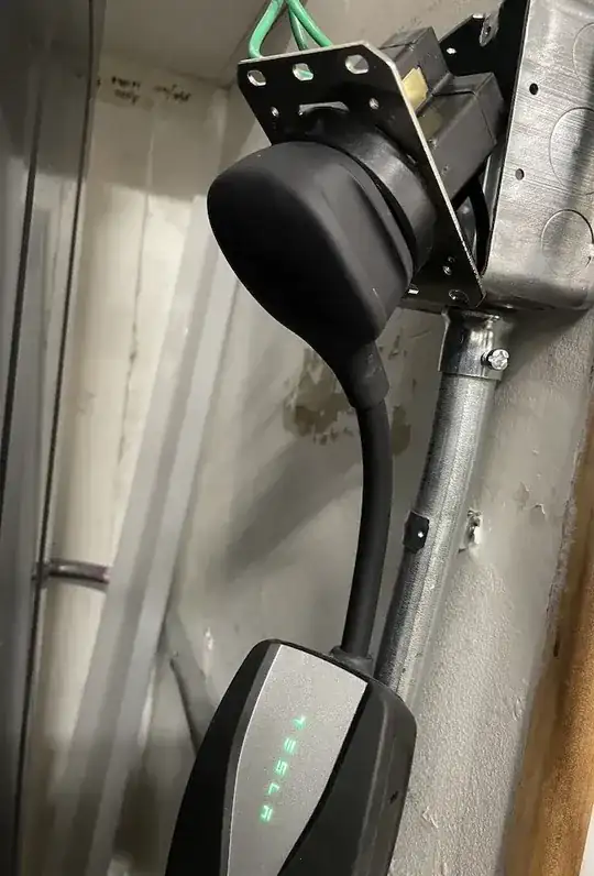

Here's my wiring on the new Bryant unit: enter image description here

Please ignore all the extra wire and the hanging receptacle, at this point I'm just wiring it like it's on a test bench. I would obviously clean this up a lot before finalizing the installation. Just showing the new ground pigtail.

  • Can you put a picture of how you installed the Bryant? – KMJ Nov 28 '22 at 06:40
    Also: the Bryant is really picky about ground wire size. I ask for a picture because if you're trying to do two ground wires like the Leviton rather than a proper full-size pigtail, you'll probably have this error. Install it correctly using a pigtail if that is the case. – KMJ Nov 28 '22 at 06:41
    Thanks for the reply. Yeah, I've got two wires in the ground. You can see the Bryant install in the second to last photo. I'm going to try to run the proper pig tail now. – amgdart Nov 28 '22 at 06:49

  • It's hard to tell from the photo, but it still looks to me like there are 3 ground wires under the screw on the receptacle, not a proper pig-tail. Hope that doesn't get inspected... – FreeMan Oct 19 '23 at 14:19
Harper's Rule: when something doesn't work, and something else is improper/not right/not to Code, no matter how totally unrelated it seems... fix it anyway - it often cures your problem.
In this case, the ground wire to the receptacle is improper. Correct the issue with the ground wire.
Note that the supply wire must go to a metal box first. In many cases, ground will automagically be delivered to the socket via hard metal-metal contact with between steel box and metal receptacle yoke.
I suspect you are doing your testing with the receptacle not physically mounted, and so that passive grounding is not happening. It's falling over to the hokey ground and that's not working.
