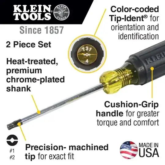

And the absolute best is a combination, such as this Klein:
Klein combination tip screwdriver
I have various Klein tools, I do not have this one, I have no stock in them. This is just the first example I found on Amazon showing this type of tip. My electrician uses the Robertson square drive, and most of the time I just pick up a regular screwdriver.

    The tip shown on the screwdriver, looks more like a Torx drive. – crip659 Dec 23 '22 at 00:21
  • OPs? Or the Klein? The Klein is hard to tell from the picture of the screwdriver, but the symbol with #1 #2 in the lower left is what the tip is actually supposed to look like, which is pretty standard for electrical and, I think, matches OP's picture. – manassehkatz-Moving 2 Codidact Dec 23 '22 at 00:23
  • The screwdriver. Symbol it is suppose to fit looks like robertson/square/flat. Might be a bad looking picture, but if I saw that, torx comes to mind. – crip659 Dec 23 '22 at 00:31

  • The tip in the picture still looks an awful lot like a Torx to me as well. I wonder if whoever made the image just used a photo of the wrong tip by mistake. (It's hard to tell since it's also pretty badly pixelated.) The other pictures on the Amazon page, like [this one](https://m.media-amazon.com/images/I/5131D4KQH+L._SL1000_.jpg), show the tip much more clearly. – Ilmari Karonen Dec 23 '22 at 12:29
  • @IlmariKaronen lookup pictures of "ECX bit" on some image search. They look just like this. They have the same sort of ridges (from a distance) as a trox would. – Brad Dec 23 '22 at 14:20
  • @Brad: I did, and they do look similar from a distance. But the one in the picture above still looks like a Torx to me — it pretty clearly has six symmetrical ridges, not two big and two small ones. Of course we're arguing over a handful of pixels in a blurry photo, so it's impossible to be sure. But I still think it's more likely that the person who composed that image just picked the wrong product photo out of what was probably a big pile of nearly identical looking pictures of screwdrivers and didn't notice the mistake because of the similarity. – Ilmari Karonen Dec 23 '22 at 15:54
    … Actually, I'm now pretty _certain_ that it's a Torx, since I did a Google reverse image search and found [this image](https://www.kleintools.com/sites/all/product_assets/catalog_imagery/klein/19555_callout1.jpg) that clearly shows _the exact same product photo_ — slightly rotated but otherwise identical down to the reflections on the shaft — but calls it a Torx. I guess whoever made the image also got confused by the similarity and picked the wrong product photo. – Ilmari Karonen Dec 23 '22 at 15:55
    @IlmariKaronen Quite possible you are correct about that. Key is the image in the lower left - that shows the actual bit style. – manassehkatz-Moving 2 Codidact Dec 23 '22 at 15:55
