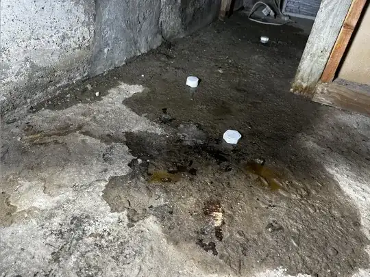

However, I am impacted by this atmospheric river which made water seep into the crawl space (and unfinished basements): The concrete perimeter foundation and sill plates are soaked and in the part with the unfinished basement the floor is wet (little bit of standing water). I see fungus growing.
  • Current measured humidity is 76.4%
  • Total crawl space size: ~1100 sqft
  • 4 vents (each corner)
  • Crawl space has two parts:
    • a small unfinished basement (small standing water, fungus growing on the floor, see attached picture)
    • A larger crawl space (concrete perimeter, sill plates and wood is wet throughout the perimeter, see attached picture)
What is the most effective and quick way to dry this out as soon as possible?

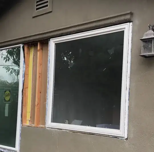

Fastest, without tearing the house apart:
4 fans sized to your 4 vents - two blow in, two blow out. Less fans will probably work fast enough, but 4 would fit "fastest" as requested. If you have prevailing winds, agreeing with them rather than fighting them will increase effectiveness when choosing fan directions.
Type of fan, judging by the (apparently) fairly small visible vent in one picture: In-line duct booster fan or similar. "Mixed flow axial" might be best. Depends how much you care about efficiency - you presumably won't be running them 24/7/365, just until you get the basement dry. I like the air movement .vs. power of the more efficient "radon fans" or the ones that have flooded the market to serve "indoor plant enthusiasts" which can be had with similar airflow/pressure/power ratings while not being restricted to vertical mounting as most radon fans are. But I was solving a radon issue and then looking at a heat balancing issue with long-term running in mind. The "plant ventilation" ones were something I stumbled across while looking for something else. That may be what I get for the heat balancing job, as they are like half the price without going to direct Asian import junque.
Additionally, any other fan you have handy to stir around the air inside the basement/crawlspace. If you somehow don't have other fans, they do sell "drying fans" specifically, which are a sort of plastic-cased squirrel-cage fan, typically, with an outlet right at floor level, but whether any will be in stock where you can get them is debatable. A plain old box fan or oscillating fan you probably already own will do what you actually need on that front well enough for no extra investment.
  • I agree, but would add that if you happen to have fewer fans than vents, blow them all _out_. That's much more effective. Most effective, though, is a fan blowing right on the moist area. There's rarely 100% humidity in the air, so evaporation will occur quickly, and it'll find its way out of the vents naturally. – isherwood Jan 16 '23 at 21:22

For standing/very wet surfaces fans will be the best(besides mopping/sponging/pumping).
You want a good breeze blowing in from one end and out the other.

  • Thank you. I edited post with more details and pictures of crawl space walls and unfinished basements and area (~1100 sqft). Would you be able to add more details? – divB Jan 16 '23 at 20:16
  • @divB One or two fans working should be enough. Will need vents/openings at each end. Oscillating fan would be helpful to move the air around. – crip659 Jan 16 '23 at 20:43
