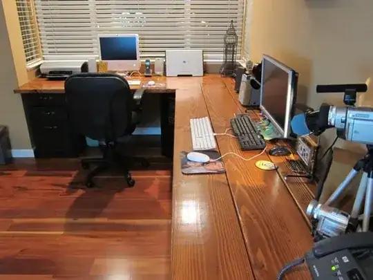

I'm currently planning a new wall-mounted computer desk and intend to use something similar to this as the top:
However, my end goal is for a wall-mounted desk, using L-Bracket mounts. I've never built a wall-mounted anything. So some of my questions are:
  • Using 2 x 10 dimensional lumber, I'm going to have a 27.75" deep desk. However, I can't seem to find an L-Bracket above 22". I feel that this is a huge overhang given the top isn't a solid sheet, but I'm not sure.
  • Is mounting the L-brackets at every other stud sufficient?
  • Do I need to run a support between the brackets (mounted 1 x 6 or equivalent)?
If anyone has a suggestion that I seem to be completely missing, I'm all ears :).
EDIT: Forgot to mention that the ends of each desk will not have a wall for support, so the entire weight will be supported by the L-brackets themselves. Overall I expect the length of the desk to be around 5' in each direction from the corner.

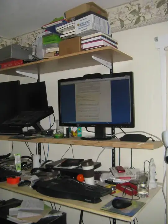

I used adjustable shelving to build my standing desk. I didn't want to commit whole hog to standing, so this let me have the option of lowering it later if I wanted. After your feet adjust in the first month, it's awesome.
I have an 18" bracket for a 24" shelf counter. I have a second smaller bracket with a shelf for the monitor, since you want the center of the monitor at eye level. Like I said, I can move the whole thing up or down in about 1" increments. I use about every 3rd stud for mounting.
It's really weight dependent. If you're going to put a lot of heavy stuff on it like a workbench, it'll need more support. For a 23" monitor or 3, phone, paper and such, you're probably fine. You can use the higher rails for bookshelves.
I don't know what the weight ratings are, didn't research that since I'm not loading mine up that much. But I've had them up for years now. I used 3"-4" screws to mount so it had more grip into the studs. Maybe 5-10 per each 5 foot rail, they have holes where the screws go.
Smaller 7 1/2" with 6" brackets can be a bit tippy when I move stuff around. You can see I have 20 lb of weight to hold the laptop dock and shelf on. I've thought about making a U piece to go on the back to lock it in.
