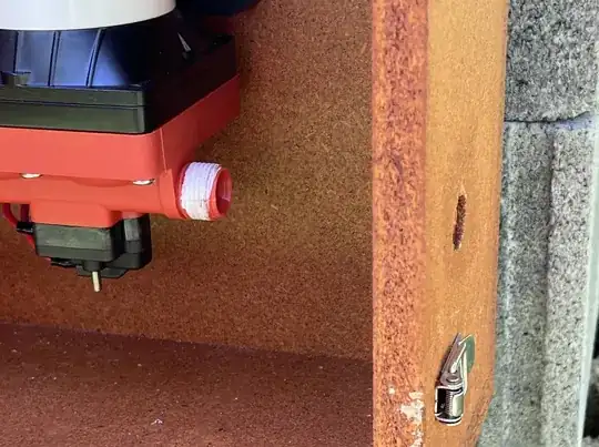

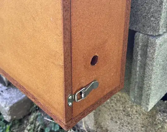

What I need: A secure way to connect a garden hose to a water pump using lead free adapters and/or connections. The pump output is 1/2" MNPT and is positioned approximately 3"-4" from the box frame. Pump can be moved horizontally but only max 1" in either direction. Technically speaking I could attach a 1/2" x 3/4" FIP x MHT Brass Flanged Threaded Sillcock Valve directly to the pump output and call it done. However that's not going to cut it for me. Using any sillcock valve or quarter-turn female hose bib is undesirable because of the flow restrictions imposed by the internal workings. A flange or mountable adapter is necessary to keep everything secure and wobble free. The daily movement of the heavy garden hose must be considered, hence the flange to mount such an adapter. This setup must be able to withstand at least 15 PSI.

Some photos to help describe my situation. Exterior Box Output
Interior Box With Pump Output

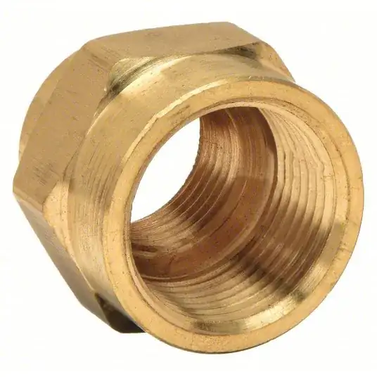

Get a threaded female to female 1/2 to 3/4 reducing fitting
Then a 3/4" x ??" nipple to go between that and the wall termination fitting. enter image description here

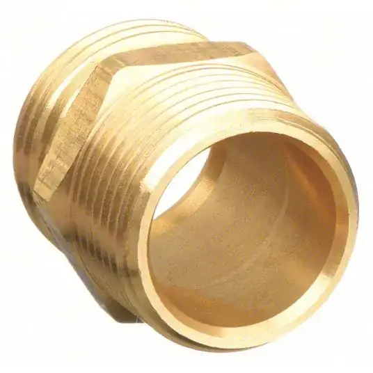

Then install a male 3/4" FNTP to hose adapter after the termination fitting.
male 3/4" FNTP to HT Adapter

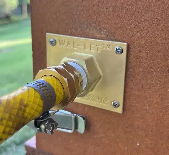

My working solution. There are multiple ways to go about this but here is what I did to convert the pump's 1/2" MPT outlet to 3/4" male hose thread via a wall termination fitting. The wall termination fitting was necessary to keep everything stationary and take stress off of the pump's threads. I connected all four pieces with plumbers tape. Then tightly screwed this entire piece onto the pump. Then four stainless screws to hold the termination fitting to the wooden box. I was able to test and hold at 45 psi without any issues. A lightweight garden hose (pictured) was easy to screw on/off since the termination fitting is securely mounted to the box.
Hardware used:
1/2" FPT x 1/2" MPT Brass Adapter
3/4" x 1/2" PVC Reducer Bushing
3/4" FIP Wal-Let Wall Termination Fitting
3/4" MPT x 3/4" Male Hose Thread Brass Adapter
