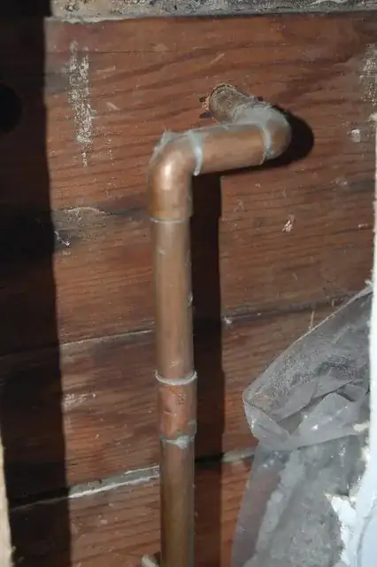

What kind of clamp would be appropriate for securing a 1/2" copper pipe that's run through a wall to the outside to a hose bib?
I'll accept a general answer. In my particular case it's a stucco wall out there. I want something strong so it does not stress the caulking that protects the wall. Freezing is not an issue in this area.

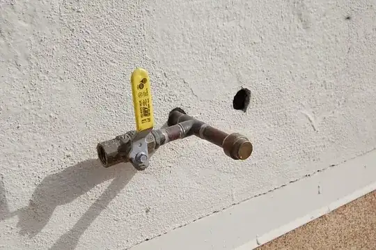

Here's the outside view: enter image description here
Click for full size image

  • While it's a good answer, this particular pipe splits in two on the outside: a sprinkler and a hose bib. Also the plumber is long gone. And this solution is rather non-repairable: hose bibs do give out after a few decades (the house is already 75 years old, and headed for another 75). This solution also presents difficulties for caulking (which more or less must be done from the inside). – Bryce Nov 18 '13 at 06:27

For your particular case, you want firstly to secure the pipe from sliding in and out of the wall opening, and secondly to secure it side to side. If you can cut a block of wood so that it tucks into the top bend and screw that to interior wood, you can then use two clamps -- one on the interior side, one on the right, to hold the copper. Here's an example:
plastic half clamp
I can't judge exactly from the picture, but a chunk of 2x4 and a couple of these clamps would likely get you covered. Some expanding foam can also help hold the pipe in place within the gap. And finally, make sure to caulk around the outside to keep water out.
