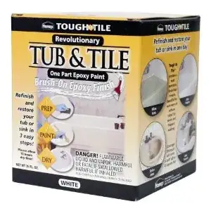

Refinishing a bathtub in place. "It's just body work - I've done this a dozen times." Incredibly messy, hard to clean up, a ton of cramped work, and even with good ventilation - just an awful job. I saved my mom a few bucks, but never again.
On the other hand, I did try one of these paints on a bathtub I want to replace. It's been a year, still looks good. Gets horrible reviews though - I may have been lucky or used a different brand.

    I used one of those types of kits to redo the shower in the master bath - an epoxy based spray-on kit. The overspray was insane - I had to construct what looked like a Level 4 Biohazard plastic tarp shelter to keep the paint off everything else in the bath. Any part of my body not covered by respirator/suit ended up painted. After 2 years it still looks great - but I probably won't do it again. – kkeilman Feb 13 '11 at 21:04
