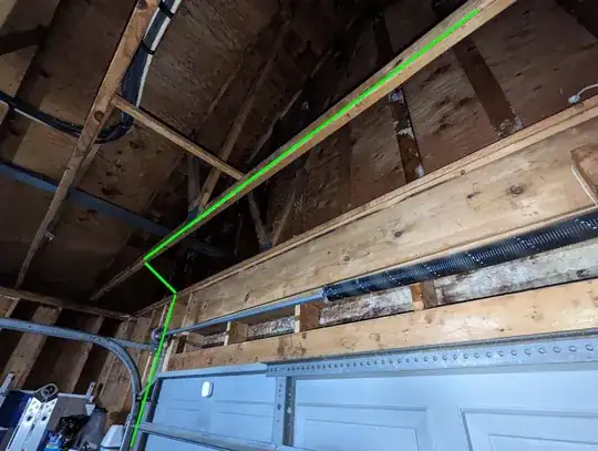

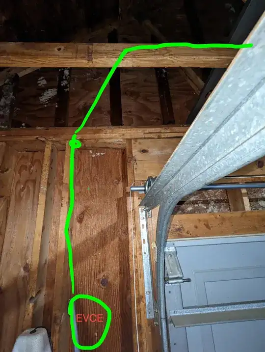

I have a 200A Square D QO (US-Maryland) primary panel and I’d like to install Tesla Wall Charger in my unfinished garage with exposed wood studs and be able to operate at its highest rating, which is 48A sustained charge rate load. Service panel and load calculations can support a 60A circuit breaker. I’ve studied the ‘20A is sufficient’ debate but decided 60A will be best for my use case. If there’s a significant cost reduction I might consider going with the 50A continuous.
I’ve gathered, Tesla Wall Charger Terminal Blocks support 12-4 AWG (3.5 - 25 mm2), copper only, 90C-rated conductor (and the installation manual cals for the conduit with no mention of other methods) enter image description hereenter image description here
Ideally, I would like to install the EVCE on the left side of the garage door, (across from the electrical panel), about 20’ away. This way when I reverse the car into the garage I wouldd have the charger on the driver’s side for easy access. enter image description here
Based on my research, I believe I have these options:
  1. Green markup - 4 AWG NM-B from the top of the panel. Run cable across ceiling joists by using the sides of existing braces then down alongside and centered on studs, drilling holes through blocking as close to the framing as possible enter image description here enter image description here enter image description here
  2. Green markup - Same run but with a 6 AWG THHN in a conduit
EVSE has indentations for both 1 3/8" and 1-1/8". I don’t have any experience with conduit and don't have a bender and would like to avoid buying for a single project if possible but this solution seems to be more time intensive but cheaper in materials
  3. Yellow markup - I realize it would be a much simpler setup if I installed the EVCE just to the right side of the electrical panel, perhaps with a 6x6 junction box, like so: https://diy.stackexchange.com/questions/262639/can-i-safely-run-nm-b-below-8-exposed-perpendicularly-between-stud-cavities-in
However, my panel doesn’t have the knock-outs on the side, only top and bottom
Question: Which option is better in my case?

I think conduit is a great plan. For a first time learner, I recommend EMT. Why? Because it's an "Erector Set" - everything comes apart and there's no waste, nothing is glued so everything can be reused. It's also a viable grounding path, but not to a plastic case EVSE and we need a ground wire in the pipe anyway for conduit fill reasons.
I would use the green route, not the yellow route, because I disagree with opinions that Romex doesn't need protection there. It obviously does; the wall is being used to hang tools.
I wouldn't worry about hanging a junction box behind the EVSE. Just bring conduit in top or bottom. To step down from your conduit size to the EVSE's opening, just use conduit reducing washers e.g. this. The EVSE has a plastic box; it's not carrying ground so the reducing washer is just there to keep fingers out pretty much.
I wouldn't bother getting a tubing bender. I'd just buy pre-formed 90s, and LB, LL's or LR's (conduit bodies) for making turns too sharp for two sweeps back to back. A junction box (e.g. 4x4 box) also works as a conduit body - cheaper too.
99% of my work is EMT conduit, and I don't attempt compound bends, I just use simple bends and couplers. I fit pipe up to the wall, note where they overlap, mark with a sharpie and cut there with a mini hacksaw e.g. Stanley 20-807. (takes little space in my electric toolbox). Leaves a negligible burr easily removed with the multi-tool e.g. Klein 1010, that's why multi-tools are wedge shaped. Don't use a tubing cutter, ever - it'll take all day to ream out the huge burr.
I would use the green route, and use "sweeps" to make the turn from vertical wall to horizontal. Where horizontal meets horizontal, I'd use either an LB or just a 99 cent 4x4 junction box (cheapest conduit body). Wire count and box fill aren't a consideration if there are no splices.
Conduit must be built and anchored total and complete before any wires are pulled into it. This is much easier, believe you me and it also allows you to do the work in sections. I'd build up the wall from opposite ends and let the pipes tell me where they want to meet.
#6 THHN is 65A. Both can be black. It's technically possible for two #6 THHN to fit in 1/2" conduit with a #10 ground, but that will leave literally zero room for the signal cable if you want to use the power limiting feature with the current transformers. So I would go 3/4" conduit. NEC rules don't allow the signal cable to run outside the conduit for reasons I won't get into here.

  • Will be doing the green run. Will post another question on how to properly file for permit. In the meantime, I'm trying to figure out exactly how to proceed where horizontal meets horizontal. @Harper-ReinstateMonica mentioned LB or 4x4. If I use an LB with a set screw and tubing through the joist, the condulet won't be flush with the joist meaning the entire run won't be either. Isn't that a problem when securing the tubing to wood with brackets and would there be a need for an offset connector? 4x4 box seems like a great idea! – Matt Jul 10 '23 at 01:57
  • Here's what I mean https://imgur.com/a/4omw3ca 4x4 box seems like a great idea but same issue with the connector, so I'm guessing this is all normal. – Matt Jul 10 '23 at 02:04
  • @Harper-ReinstateMonica Since I won't be able to this myself due to town not letting me add any 240V circuit without a license I had few estimates done. All of them quoted metallic sheathed flexible cable for this installation. No one mentioned conduit until I asked which they would do while doubling the labor from 2-3 to 4hrs an up. Any disadvantages to MC cable in this scenario I should be aware of? – Matt Jul 18 '23 at 11:52
  • Typically they want conduit to confer physical protection so you don't get a blowout if someone hits it with a rake or crushes a ladder into it or something. *MC cable is not adequate to meet physical protection requirements* and would have to be behind e.g. drywall. In that situation I might be tempted to skill up on building EMT conduit and do the conduit run *myself*. Why EMT particularly? It screws not glues, so novice mistakes don't waste hardware, just maybe some pipe, which is cheap. Pulling the wire is practically a victory lap, 1 hour job. – Harper - Reinstate Monica Jul 18 '23 at 21:51
