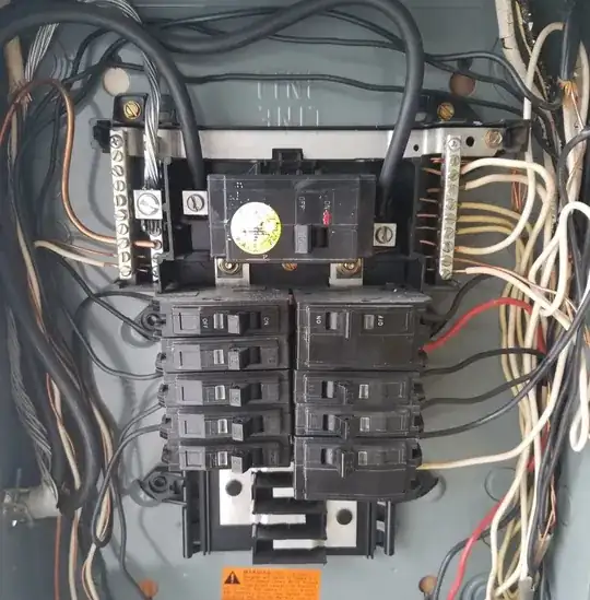

    What is the size of the breaker? The breaker and the receptacle should match what the dryer needs, usually 30 amp. 30 amp circuits must have 10 gauge or larger wire. The dryer probably has neutral bonded to ground on the dryer, this will need to change also, when you switch over to 14-30. – crip659 Jul 11 '23 at 11:06
  • What wiring method is used for the rest of the run back to the panel? – ThreePhaseEel Jul 11 '23 at 18:45
