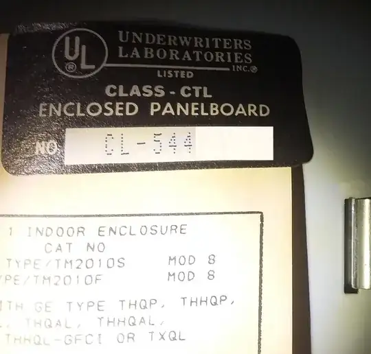

  2. Can tandem breakers be used? (The panel states use of THQP [half width] breakers is allowed)

  • FYI nearly every breaker in that panel is illegal - Type C and BR are not substitutes for GE. You need GE breakers that are listed on label, or other types whose manufacturer has tested for compatibility in GE panels such as Bryant/Eaton type "CL" (but not type BR). – nobody Jul 18 '23 at 01:26

Use THQL and THQP breakers, like the label says
This will afford ample opportunity to access the full 40-pole capacity of this panel.

  • THQL is the correct model of full-size breaker for this panel.
The THQP thin 1-pole breakers are half width and must be used 2 per space.
The THQP 2-pole breakers work by using a 1” wide breaker that straddles two breaker spaces. They need a THQP thin 1-pole above and below them to fill out the spaces, though you can daisy chain a stack of THQP 2-poles with only one 1- pole at top and bottom of the stack.

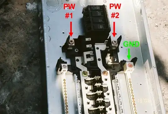

Edit to add photo: odd little cruciforms found where a GE panel supports thin THQP breakers. Photo from electrical-forensics.com
  • This box is a TM2010, CTL, with a circuit diagram that shows only 20 poles. So it appears that even using the THQP breakers, its not possible to double the poles. Is this a correct interpretation? – pathfinder Jul 25 '23 at 18:08
    @pathfinder Possibly, but no need to guess. Pop a breaker off and look for the very distinct "cruciforms" on the bus stabs. See edit – Harper - Reinstate Monica Jul 25 '23 at 21:37
