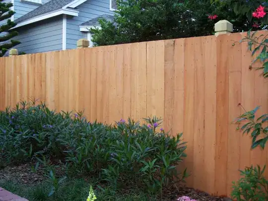

I have had problems with a fence on one side of my garden because of wind in Montreal. The posts end up leaning away after a few years. Part of the problem might be how the posts were put in (perhaps not deep enough), but the wind is a big factor.
EDIT: Current fence design is 2m high with posts roughly every 15 feet, similar to the image below: privacy fence image

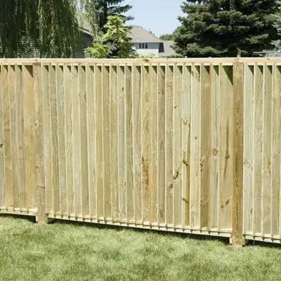

I'm wondering if a board-on-board fence design (aka shadow board or shadow box fence) will help much. It seems that there's more wood involved in this design, and so it will cost more. I'm not sure how much it reduces the wind load, and I'm trying to get an idea of the cost/benefit of the design.
Here's an image to give you an idea of what I'm talking about:
shadow box or board-on-board design of fence

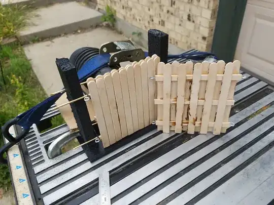

I am posting this response several years after the fact since the information contained above did not match my personal experience. I live in the foothills of Denver, CO where we routinely see high winds and where shadowbox fencing is preferred for its apparent wind shedding characteristics. I am also a mechanical engineer and in need of a new fence after ours was blown over (a double sided solid picket fence) and while I had not previously investigated the issue, I thought an experiment and some calculation might be in order.
While surface area is an important scaling factor in fence design there is another factor that is being ignored here witch is the Coefficient of Drag, which scales 1:1 the same way surface area does. Drag Coefficients are typically numbers between 0 and 1 for structures, so if a structure has a drag coefficient of .5 it will have half the force applied for a given wind speed when compared to a structure with a drag coefficient of 1.0.
I mocked up both a solid picket fence as well as a shadowbox fence with Popsicle sticks and bass wood for the stringers. They were attached to a 3d printed test stand via rubber bands (see image) Each was constructed with the same surface area and subjected each to "wind blasts" from the exhaust of my shop vac.
Each fence section was alternated in the test jig and tested 5 times for a total of ten tests. The deflection of the fence section due to the wind was measured with a .25mm scale at both the top and the bottom of the fence section during each test.
The results were consistent from test to test with the shadowbox fence demonstrating less than half the total deflection of the double sided picket fence.
Given that the surface area, air velocity and air density were the same for each test, and that the alternating of samples from one test to the next would eliminate any variability of the jig/test setup. I am fairly confident that the shadowbox fencing has better resistance to wind loading.
Jig With Fence Section
Both Fence Sections

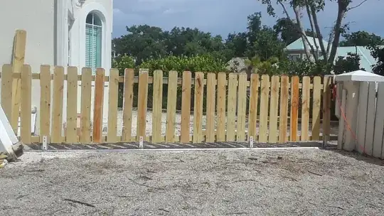

I build wood fences and gates in South Florida. Shadow box fences here have posts a minimum of 24in in the ground on center every four feet. I do not have this physics involved in comparison when wind load is the subject. But it stands to reason that if wind can penetrate through the shadow box Style fence as opposed to a more solid surfaced area like board on board or privacy styled fences the wind resistance must be less (meaning the shadowbox design is preferable in high wind situations). It is almost certainly why 90% of the wood fences in South Florida are shadow box.
Tbe attached picture is of a 20 foot long wood rolling gate being installed in Key Largo, Florida. I halted Construction on this gate to provide the client with the opportunity to change their design request for a board on board style (that would match the fences on either side of it) for a shadow box style for this very reaso - to reduce stress from wind not just in the event of a hurricane but for everyday coastal breezes as well.
Fence
