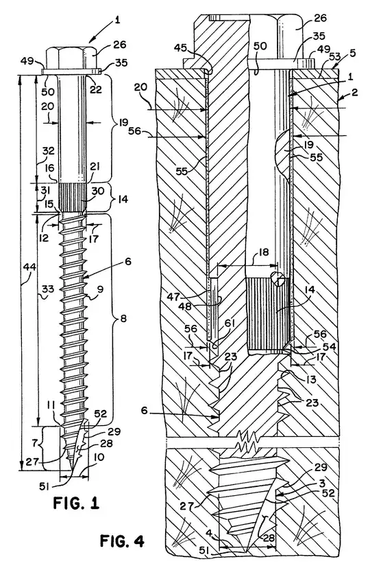

Here is a related patent http://www.freepatentsonline.com/7832173.pdf that claims in page 7 of the PDF that the purpose is to increase the screw's resistance to lateral displacement by mashing the fibers that will be next to the un-threaded shank.

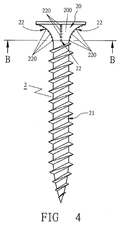

And as for the ribs on the underside of the screw head, here is a related patent http://www.freepatentsonline.com/EP2546533A1.pdf that claims in paragraph [0005] that the objective is to lower the lower resistance when the screw is being locked into a wood piece for enabling the screw to carry out locking smoothly and quickly. Note that the patent discusses various kinds of ribs, including the ones pictured in the OP.

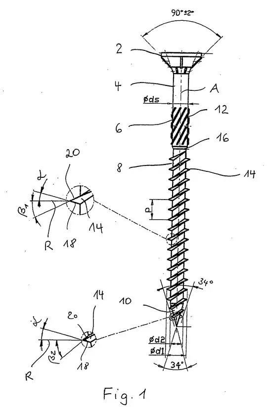

And to over do it, here is yet another patent, but this time referring to them as 'milling ribs' ...
http://www.freepatentsonline.com/20070269287.pdf
