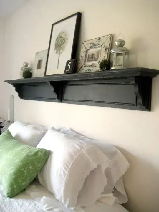

I just built a shelf for a bedroom based on instructions found at Happy at Home. Problem is: the blog doesn't explain how to hang it!
Can someone help me figure out a clean way to hang this shelf that doesn't involve screws on the exterior of the shelf?
