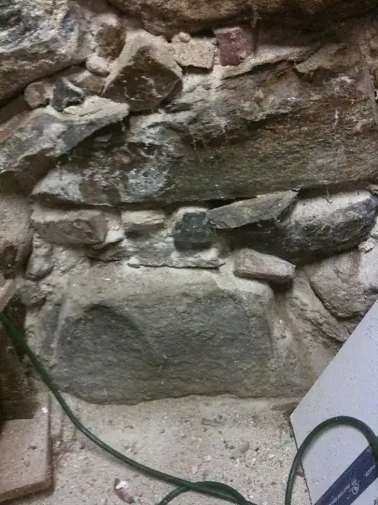

The old mortar is crumbling, and sandy mortar is falling out onto the basement floor. I plan to remove the crumbling mortar (see related question on how to remove), then point the foundation with new mortar. But what kind of mortar should I use?
crumbling mortar
I have had a hard time finding definite answers about fieldstone foundations on the Internet, but I'll include some of what I've found here. First, David Valley has this to say about fieldstone foundations:

This page seems to suggest that I should be using not straight type-S hydrated lime, but type-S mortar, which consists of one part Portland cement, ¼ to ½ part lime, and an amount of sand equal to 2¼ to 3 times the total volume of cement and lime.
Do I need to analyze the existing mortar to make sure that the new mortar has the same lime content, as suggested by some?
Should I expect the new mortar to start crumbling and releasing dust soon, or should it stay solid and dust-free for many years?

I'm on the same quest. I have the exact same type of fieldstone foundation as the posted picture above, where the original mortar is falling out and creating a dusty mess around the interior of the basement. After some research, my wife started the tucking process using a type N mortar mixed with sand but she never completed the project. This was about 5 years ago and it still looks like it was done yesterday. Now that I have some spare time, I'm going to jump in and start where she left off. Logic and research is leading me to this conclusion: 1. Since my house was build in 1870 and Portland cement was not widely used, The original mortar has got to be a lime based mortar and I should probably use a lime and portland mixture. (which will be much harder than the original) 2. The fieldstones in my foundation consist of granite and quartz type rocks, which are extremely hard, so my mortar is never going to be harder than the rock. 3. Since the foundation is below grade and not subject to freezing and supported by dirt on four sides, the only concern I have is moisture problems. In conclusion, since type N can be a substitute in the chart for type S, and I've started with type N and it looks like its holding up well, I should continue with the type N and sand. Having said all of that, I would be interested to know what Mr, Ljosa decided to go ahead with.
