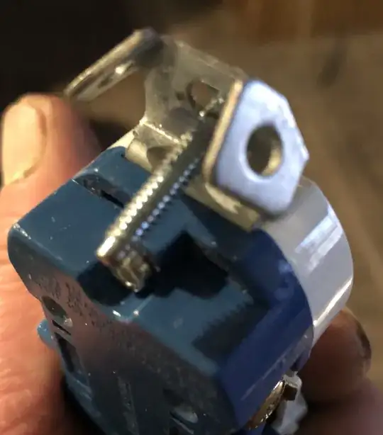

Use longer screws (#6 x 32 x 2"). If you get the right pack, it comes with the nuts. Run the screw through the receptacle and put the nut on the backside of the receptacle. Works like a charm!
(https://i.stack.imgur.com/cU5SW.jpg)
I have not been able to find this solution to (shim...space...) keep an electrical outlet away from the wall,
So it can sit ABOVE new tile... ( ie: kitchen backsplash)
The tabs on both sides of the outlet mounting screws can be bent back like “dog ears” therefore allowing the outlet the spacing needed for install after tile.
Check to make sure you aren't violating 314.20 on box setback... – ThreePhaseEel Apr 09 '18 at 11:48
The breakaway ears were never meant to be used as you describe here. They should be either in the original flat position or completely removed. It is a kludge at best to do as proposed here. – Michael Karas Dec 24 '18 at 22:59
