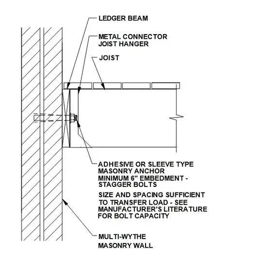

MULTI-WYTHE MASONRY WALL : ADHESIVE OR SLEEVE TYPE MASONRY ANCHOR. MINIMUM 6" EMBEDMENT. STAGGER BOLTS. SIZE AND SPACING SUFFICIENT TO TRANSFER LOAD. SEE MANUFACTURER'S LITERATURE FOR BOLT CAPACITY.
Page 33 (actual p. 37) Drawing E3, which isn't particularly helpful because it's a side view.
https://www.chicago.gov/dam/city/depts/bldgs/general/EZPERMIT/PorchGuidelinesMay2011.pdf
I do two per cavity, staggered, half of which always feel like they didn't grab so well. Can't remember if I used 3/8" or 1/2" sleeve type. Whatever they are, they're 8" long.
1/2" x 8" Tapcons are $90 a box but that's what I'd probably use now. I'd rather fail to meet code then it fail. And if your code supersedes my code, then I want to 'meet' your code. People died and then the city of Chicago put this out for free.
Pocketing the edge beams is another way but that's no fun at all, and there's no drawing. Edge beams can also be hung on overly elaborate brackets {drawing 3B, page 29 (33)}. Either of those ways the, now needing to be sistered ledger, hangs off the edge beams with joist hangers, slightly away from the building, which does facilitate tuck pointing.
Plot your joists first, including space for the hangers, so they don't end up being in the way.
