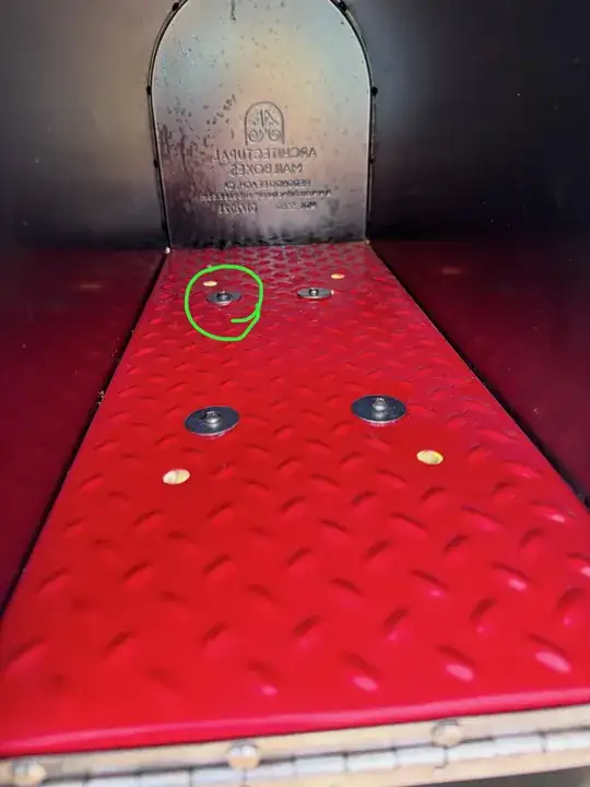

I thought replacing this mailbox would be easy... four bolts out and a new mailbox (identical to the old which has exterior issues) in.
But then I noticed the four bolts were actually Phillips head screws there were in there very tight. Using a stubby screwdriver, I was barely able to turn 3 of the 4, but the back left one in the image below stripped on my. I tried loosing these up with WD-40, but it didn't do anything.
It takes most of my arm to reach those back screws and I can't get enough downward pressure to hold the Phillips head screw in while also turning. I also tried a ratchet with a screwdriver bit, but there wasn't much room to ratchet and of course with the screwhead starting to strip the bit wouldn't stay in.
Assuming I get these out, I will try to find similar threaded bots, so a ratchet wrench can be used, but how do I get that back left screw out without harming the wood below the mailbox that it is screwed into?
Photo: https://i.imgur.com/ttKqjzz.jpeg
Problem screw in the back of the mailbox

    Too late now, but are you sure they were Philips and not pozidriv, which look a lot like Philips but strip if used with a Philips screwdriver – Richard Tingle Nov 03 '23 at 14:25

  • @RichardTingle To be fair, Philips head screws also round out with a Philips head screwdriver. I suspect they were never meant to be for manual use. – Andrew Morton Nov 03 '23 at 23:11

Probably need to "think outside the box" a bit.
Will the existing mailbox be disposed after it is removed? Then don't worry about removing it delicately. Pick up a claw hammer, tin snips, a reciprocating saw or jig saw or hack saw, or similar tools and smash and cut a hole through the top of the mailbox. You can create good access to the stuck screw and then apply your full strength with full-size tools to solve the problem.
If the mailbox must be removed without damage, try locking pliers on the head of the screw. They're not likely to hold well enough to turn it but it's worth a shot.
The head of the screw could be ground away with a small rotary tool (aka "Dremel"). After the mailbox is removed there'll be a stub of screw remaining. You may be able to remove that with locking pliers, or you may be able to simply grind it down further and abandon the screw in place. The fasteners for the new mailbox can probably go in different locations after all.

  • And since there are washers under the screw heads, dremeling the one away won't hurt the mailbox even in this hard-to-reach place. You might need a new washer though ;) – arne Nov 03 '23 at 07:59
  • The mailbox would hopefully be salvaged but if it can't be, it can't be. Thank you for multiple option suggestions! – Sunny Nov 03 '23 at 13:49

  • An [oscillating tool](https://www.homedepot.com/b/Tools-Power-Tools-Power-Multi-Tools-Oscillating-Tools/N-5yc1vZc2b2) with a [flush cut blade made for metal](https://www.homedepot.com/b/Tools-Power-Tool-Accessories-Oscillating-Tool-Attachments/N-5yc1vZc8y4) would also work really well. Even a saws-all with a metal cutting blade could work, but would be a lot less easy to use. A grinder could also work, or a flex shaft on a drill could drill off the head. Lots of ways to remove that screw head. – computercarguy Nov 04 '23 at 15:48

After removing other 3 screws, try twisting the whole mailbox counterclockwise while pulling up - it might loosen the screw.
You can also use the old fashion method:
  • Take a blade from metal saw, wrap it in cloth and use the blade alone to cut a slot in the screw. Wide cutting blade is preferred so it doesn't flex too much.
  • Use flathead screwdriver to unscrew the screw.
Note: You can also buy a dedicated handle for using the blade alone. Useful in tight spaces. And much more convenient than wrapping it in cloth.

  • Nice, wanted to say the same. If the other three screws are removed, perhaps the mailbox can be rotated on the last one as a massive wrench. (Of course, other solutions are great, but this just might be the cleanest if the box is gripping the screw tight enough.) – Luke Sawczak Nov 03 '23 at 10:56
  • Was just going to post this answer. It's usually pretty effective. – Jack Aidley Nov 03 '23 at 15:11
    Instead of cloth, wrap a hacksaw blade in a few layers of duct tape. – Chris H Nov 03 '23 at 16:58
    Note that two of these suggestions can be combined. If, when rotating the box, you have locking pliers clamped on the head inside the mailbox, you might get the torsion that one or the other couldn't get you. – Dewi Morgan Nov 04 '23 at 07:39
    dremel with cutting disk could work, rather than hand filing/sawing, maybe? ... ah - next answer :) – Mike M Nov 04 '23 at 11:13
  • @MikeM Dremel is an expensive tool not everyone has. It will be also hard to aim with the disk perpendicular to user. A basic saw is a standard equipment in any workshop and will work just fine. Can even be used blind - just put the finger to guide the blade. I would not put my finger next to dremel. – Thomas Nov 06 '23 at 08:59

Using a cutoff disk in a Dremel (or similar rotary) tool you could cut a slot for a flathead screw driver, or cut off two of the rounded sides of the head to make grabbing it with a wrench (if you're naturally gifted at cutting parallel in an awkward position) or locking pliers (for the rest of us) more practical.
If you are not refurbishing the mailbox the suggestion already made to cut it open could help.
I find this an unusual (and inferior) mounting method. All the standard mailboxes of this general shape I've met have holes through the sides, below the bottom of the box, which you can put screws or lag bolts through with good, easy access, into the side edges of the board that fits into the recessed bottom.
  • Mine have both mounted with screws through the bottom sides from the outside. Even if the new one doesn't have holes here, they can be made and this would be the way to do it! – FreeMan Nov 03 '23 at 10:58
At this point, I'd be thinking about grinding the head of the screw away and then using some vice grips to remove the screw.

  • Grind enough of the head away and the mailbox should lift off easily. Then the stub can be ground flat and the new mailbox fitted after any painting. – Criggie Nov 03 '23 at 07:42
Does the mailbox have a lip over the wood it's screwed into? If not, you can try taking a metal hacksaw blade off of the saw (maybe hold with vicegrips), slip between the mailbox and the base, and saw through the screw.

Get a left-hand drill that fits the stripped-out socket. Take it easy with a power drill. You will feel when it catches. I have done this many times at work.
