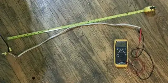

Lab experiment
As an example, I've connected about 1 meter of NM 12/2 cable in a way similar to your situation. I connected neutral and line to the outside two conductors of the NM cable, and left the ground floating. I measured 31 V between neutral and the ground wire:
Overall setup
Source connections
Voltage measurement

Here's an example calculation (with many simplifications, worst case scenario, etc), showing that this "phantom" can be quite large, written in Matlab code. It assumes that the "red" connector is between the "hot" and grounded wires, that you're using 12-gauge wire, 19 mil of insulation on each wire, dielectric constant of PVC, your multimeter's input impediance is 10 Mohm, and no inductive coupling (only capacitive coupling). It uses the capacitance formula on Wikipedia for a pair of parallel wires. The assumed wire length is one meter. The result is that you see a phantom voltage of 33.4 V, similar to what I measured in "real life". This shows that 16 V is a "reasonable" phantom voltage that could be measured with modern, high input impedance, voltmeters.
