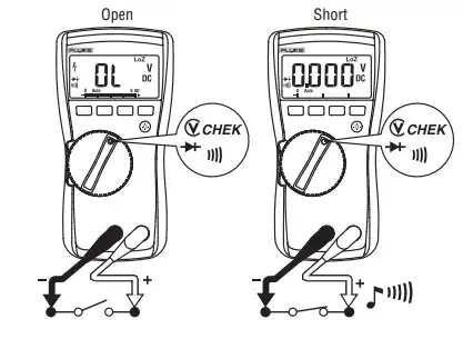

Checking
If someone has removed the red tape, you can:
  • turn off the lighting circuit at the fuse-box/consumer-unit,
  • check there's no voltage present with a voltage tester (preferable non-contact type) and
  • separate all the wires,
  • use a continuity tester to see which red & black pair are connected/disconnected by the switch
A typical Non-Contact Voltage detector (NCV) and a typical mains tester
Finding which wires go to a switch using a multimeter (at least CatII 600V rated) on an isolated circuit (off at fusebox and tested for no 240V AC).
